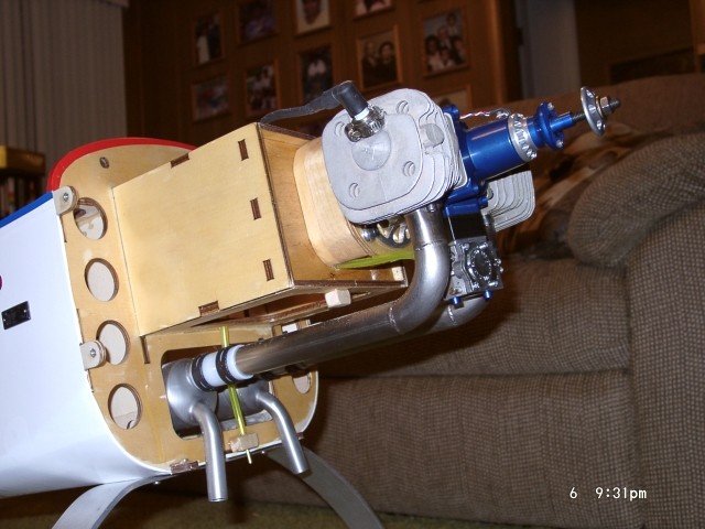

Hey Miles, when I first got my Wild Hare 330, the BME 110 wasn't quite out yet, so I put in a BME 105, and used the KS 86 V4 cannisters, which is the same as MRT 1750 is going to use. I've included a pic of my install. I got the stainless steel header parts from Desert Aircraft and had them welded together. The header length should be 11" from the flange to the cannister inlet. My prop of choice was the Menz 27x10, but sorry, I don't remember what rpm I got.
Several months later,when the 110 came in, I needed a new header, so this time I got the parts from Desert Aircraft, and, using their brazing rod, I made up the headers myself rather than having them welded. It's very similar to sweat soldering copper pipe, and I have yet to have a joint fail. Ernie, just call Desert Aircraft, they have all the header parts you'll need.

All the parts including mufflers I bought from DA. You can get a exhaust flange and what ever pipes you need straight, 90', they are thin wall stainless steel, they snap together to make it easy to braze (silver solder). Like Tim said it's not hard to make your own.
order a couple extra pieces to practice with make sure you buy the silver rod from DA also it has flux on it and works well on clean pipes heat till cherry red then apply the silver rod it will flow in like solder on a water pipe. Once you do one you will not be looking for headers ever again you can make any shape or size you want or need. You will need a Mapp Gas torch $40.00 at home depot, it's like a propane torch except it gives off more heat enough to braze with.

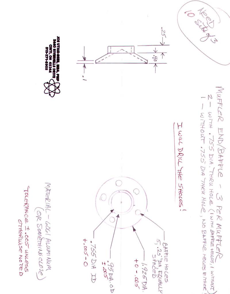

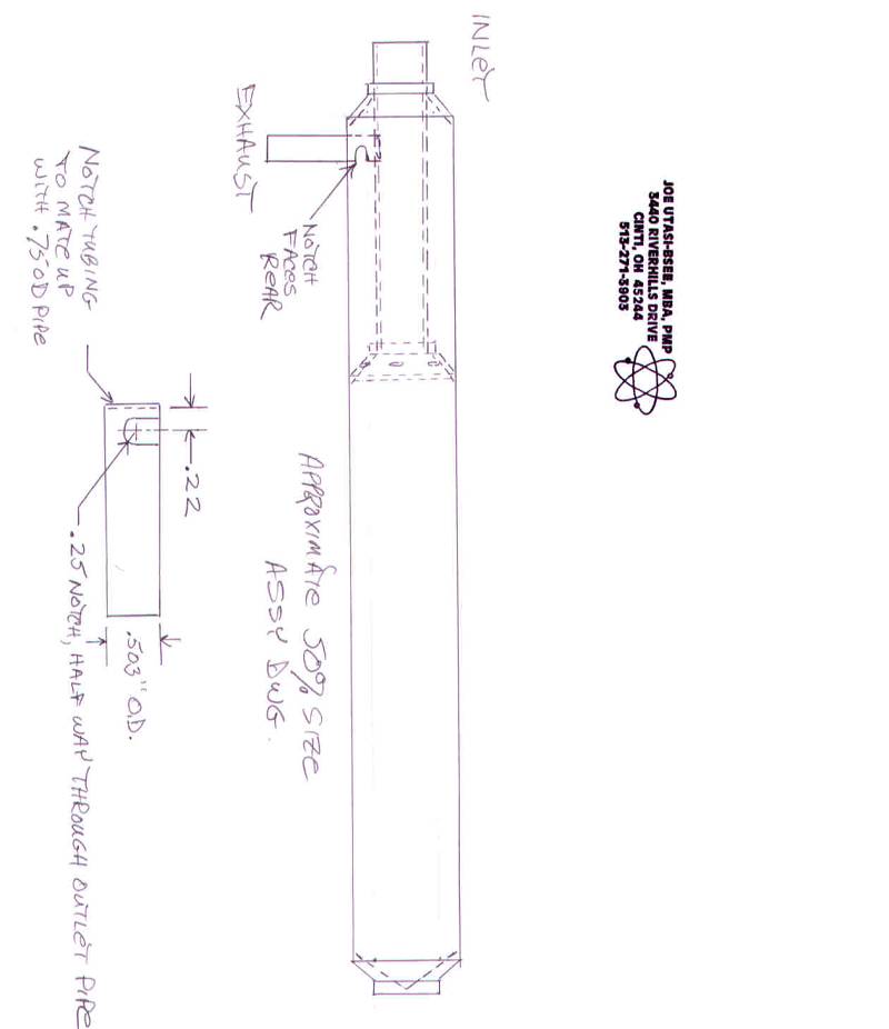

For those of you willing to experiment, I'm building some "home brew" cans. I have several variants - some designed as "cannisters" which might be subject to inlet length tuning opitmization and a few with internal baffles to actually "muffle" the engine, rather than tuning it... If anyone is interested in doing some experimenting, please drop me an email off list at [email protected] .I'm doing all my own work. I bought an AC Tig welder and have started practicing. Actually welding thinwall 6061 is VERY difficult to do without burning through and ruining it!! My mufflers will be 12 inch and 16 inch overall with 2 inch OD. Available as "tuned" or "muffled" (with extra baffle on the 16 inch version) all up weight is 7 1/2, 8 1/2 and 9 1/2 ounces for the 12, 16 and 16 baffled. A very unique part of my design is machined "cone" shaped end bells, to help broaden the RPM range where the engine is particularly happy. I expect to be welding some up this week. Inlet size is .75 OD. outlet is 5/8 OD. Front exhaust. All is experimental, buyer beware, could be junk. But I stayed at a Holiday Inn last night!!

I always put small holes in the baffle. Effective surface area total of all holes is equal to inlet pipe area. Outlet pipe (stinger) is sized .6 the diameter of inlet pipe (same as all other muffler designs!) Internal end is wide open, with about .3 to .4 inch gap from end of stinger to sidewall of inlet tube (same as other designs). Only thing I'm changing is adding 30 degree cone shaped end bells to reduce "peaking" and do more "muffling". More trial and error than science. Lots of building and testing to get the desired result... If you're into the science, there is a free program called pipe_dsn.exe on a site I found that sells a professional design program called "MOTA". This is more of a "tuned pipe" however, really intended for max boost at a fixed RPM rather than a smooth effect over the full RPM range like we use for IMAC.
