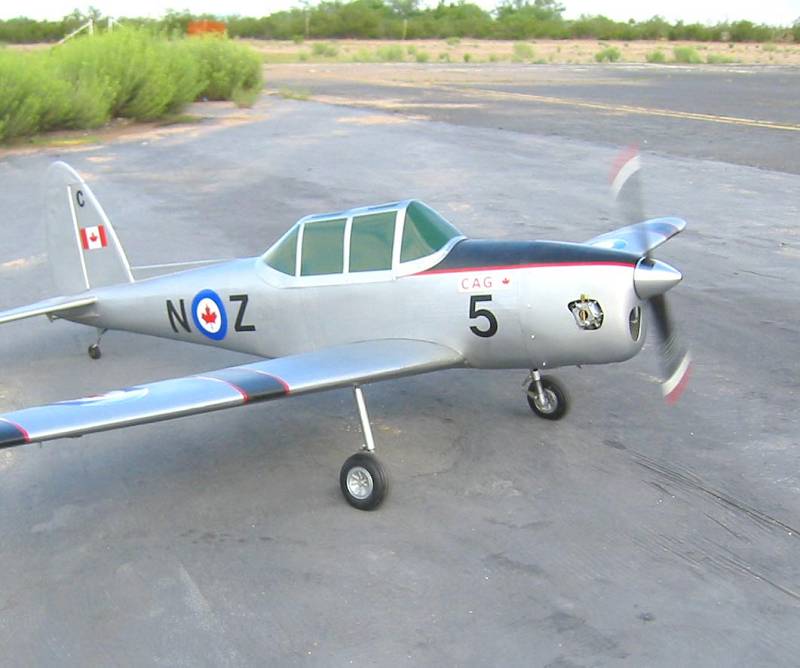

Tried a few soft mounts, and never liked 'em.
Just flew my G-26 again this Sunday morning in my Chippy.
" vibration-prone " ? Rediculous !
