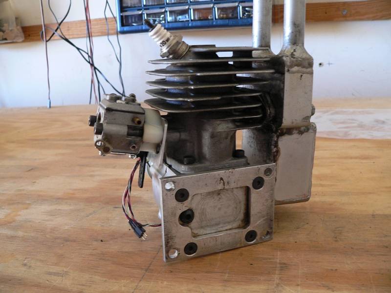

I've got a engine that I think is a Brison 3.2, but I have been told that it might have an A&M crank in it. Does anyone recognize this motor? Notice the bent linkages and the BIG bell crank. It runs as is but I would like to do it up right and I would like to go to an electronic timing advance. How difficult is that to do on this motor? The ignition module that is with it has a date on the back of 8-94, would I be better off chucking it and buying a new one rather than trust it in a new bird?

It looks like a Brison to me. I'm not sure about that funky prop adapter. On the older Brisons they had that bell crank and the white plastic ring as a spark advance. I would get a new ignition module, or if it runs all right, I would at least contact CH electronics and see if they had any problems with that module. It would be a shame to throw all that money away for a faulty ignition module

It's an OLD A&M...Take the 6 bolt adapter off...If the end of the crank is smooth with no centering hole the crank is an A&M, not as good as the Sachs crank..If it's a Sachs crank the engine is just as good as a new one, you can't wear out the cylinder and piston....You can lock the timing ring at 28 degrees BTDC and get a syncro module from C&H to use the ignition you have, if it's good....
Many of those old A&M engines were timed way too far BTDC, check it out....

Like RCI said remove the prop adapter and see what the end of the crank looks like. OR Open the throttle all the way and shine a light inside and look at the rod. If it is aluminum its got a A&M crank, if its a bronze/cooper looking rod then its a Sachs rod and a MUCH better engine.
The A&M crank had the wrong metal harding, wrong fit, wrong balance and used the cheapest bearings that could be bought.

I took the prop adapter off and the crank has a big dimple in the end. I also looked at the rod through the carb and it is the dark copper/bronze color. I noticed that you refered to it as a A&M or Sachs crank not an A&M or Sachs engine. Does this mean that the engine itself is a Sachs engine if it has the features described above? Just curious about the lineage.
Also the ignition module has an 8/94 date on the back. Will an ignition that is this old tend to generate more RFI than a newer version or should I not be concerned? I don't know its history (i.e. abuse, crashes, etc.) Should I replace it just to be safe or just try it in the plane and do a good range check on the ground? I still want to switch it mechanical to electronic advance. Any tips on performing the switch?

Just before Brison took over, I believe A&M switched to using the Sachs crank. A&M originally only used a Sachs piston, & cylinder, on their own case. After Brison took over the cases were also changed. I talked to Gary about this when I got my first 3.2, and am pretty sure that is what he told me. It has been about 7 or 8 yearsago. Your motor could be an early Brison, or late A&M. I have several brown box ignitions that work fine. In fact the only bad, (inoperative) ignition I have is a newer silver box. Yours has the Bosch shielded cap already, so if it works, it should be fine. I have the mechanical spark on all my engines and would not care to change it out for the electronic advance. That's just me though.

The engine has a Sachs cylinder and piston, The Sachs crank means an early A&M. A&M made the crankcase out of billet.
Later to increase profit they made the MK1 crank trying to copy the Sachs crank. After lots of problems they tried the MKII cantlivered crank which only a little better. They then went bellyup.
Brison bought A&M in a bankruptcy court. Then spent a long time getting the MKII crank right.
AJ sounds like you got a keeper.
