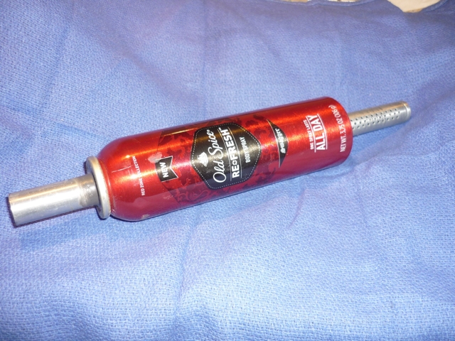

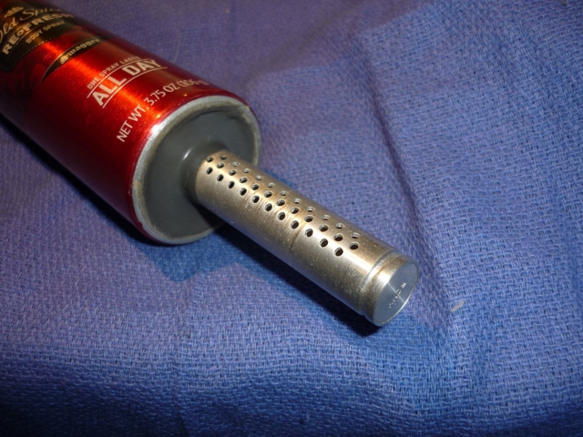

Yes what they stated. The tube looks like this one shown below. You place a plug in the middle of the tube. The plug can be glued in, or crimped in. Even some screws put in to help keep the plug in place. The on both sides of the plug, you drill a series of three sets of holes. If you add up all of the holes diameters, then the holes total size is larger than the tube inside diameter. But since the hot gasses cool and shrink in volume the second and third set of holes become progressively less.
Anyway here are some pics of how I did it for a smaller muffler. One can scale it up or down in size as needed.
Oos sorry I forgot to add the pictures.

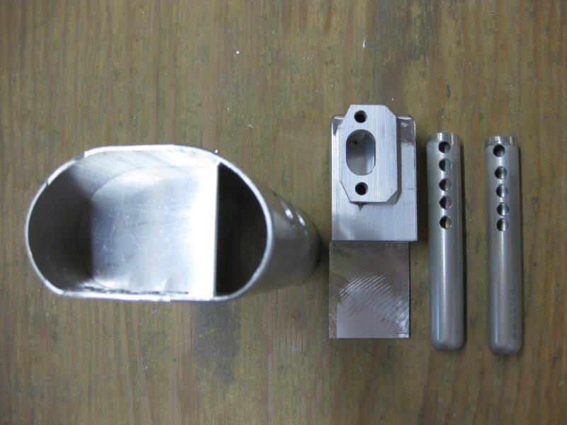

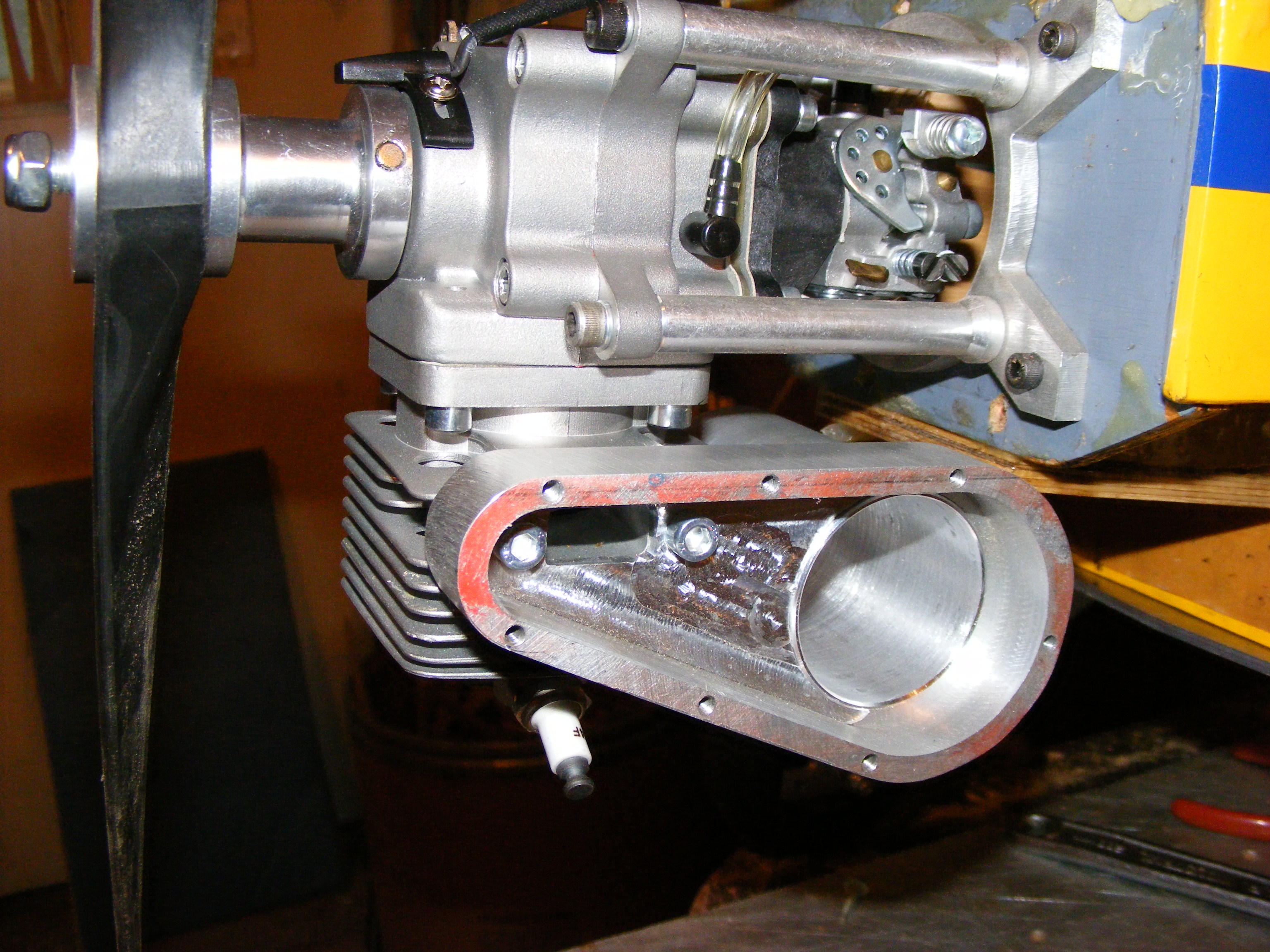

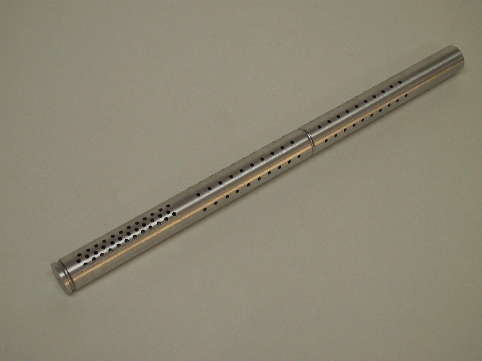

Ok I will add my 2 pennies worth. In doing some research on mufflers I ended up t/t a engineer ( do to h/d computer crash I can't give you his addy ) But what he told me a bit of back pressure is not bad and generally come's from the first bend the gas comes to, that said baffles with holes can help with the harmonics of the sound hole dia.s are critical and the volume of the holes MUST be larger than the exhaust port size and the holes in the tubes also have to be more than the port size like in the pic above, and placed so that the gas has to change directions to go thru, and out. the biggest help is the volume of the muffler can it self.
So with the above in mind I built a mockup and had Bison mufflers build one for me, and it works great with a calibrated sound meter I get and avg 86 db's at 9.
will try to figure out how to post pic's as rcu is not letting me
cheers Bob T
Old 06-24-2015 | 03:23 PM
Joined: Dec 2004
Posts: 5,953
From: hastings, MN

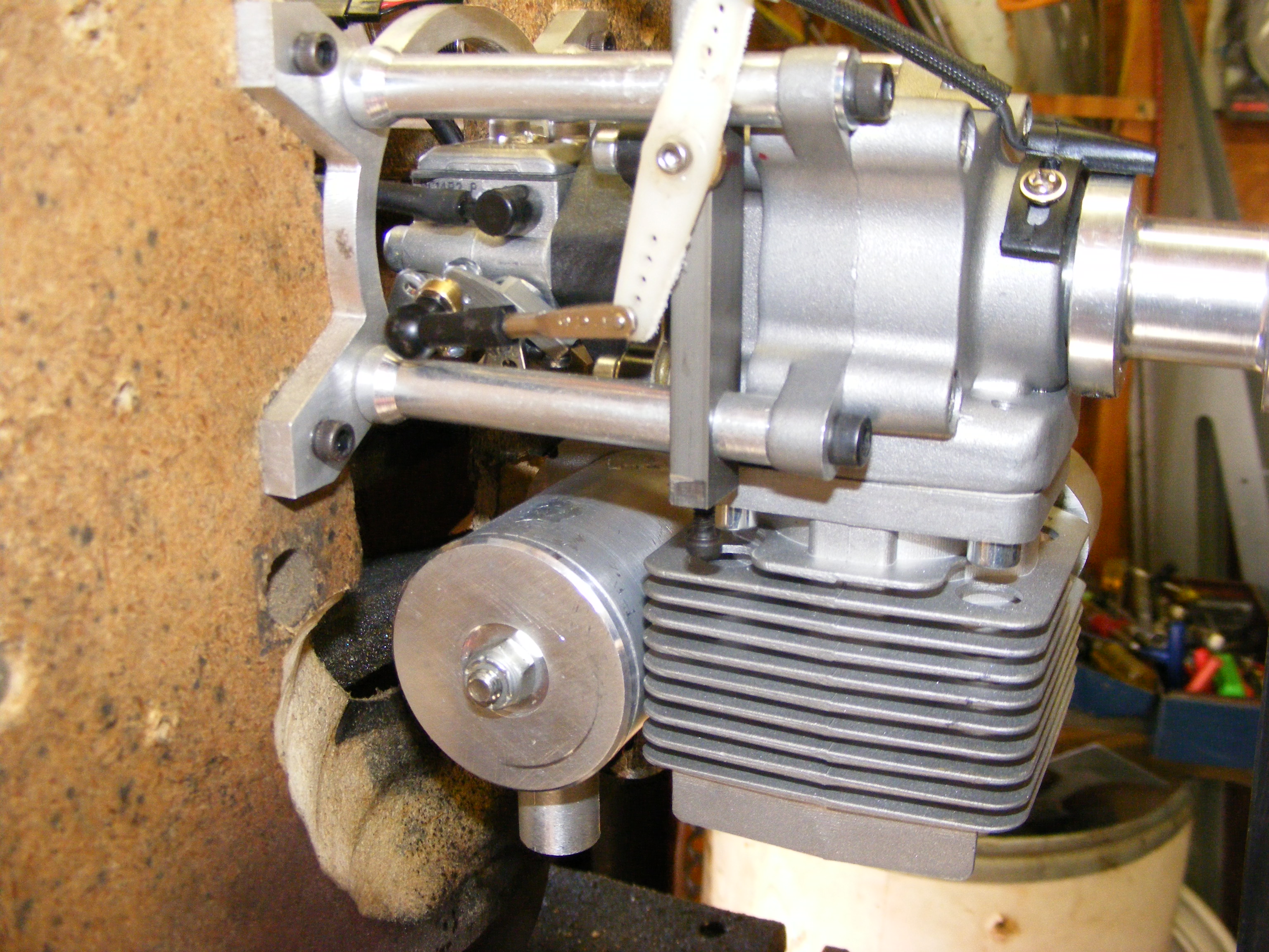

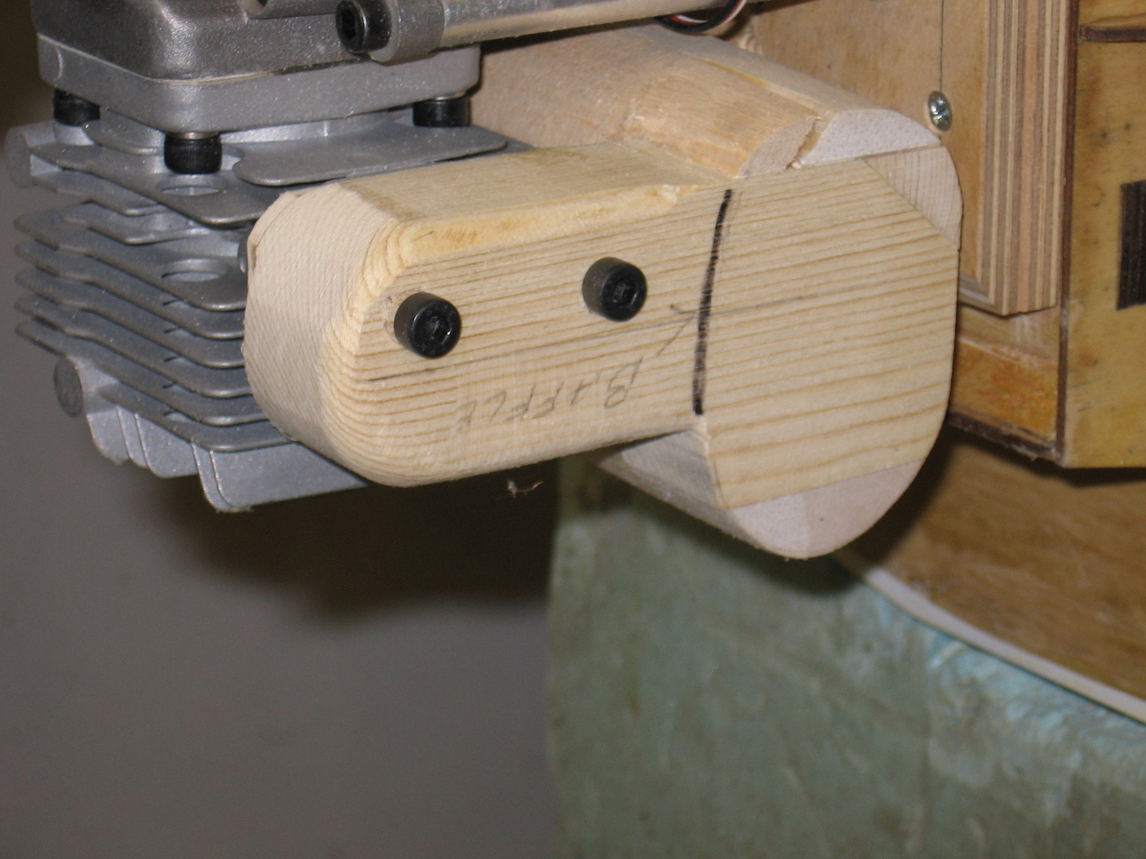

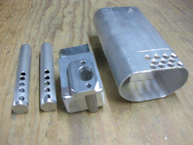

First pic is mock up to fit space, second and third pic's are parts befor welding Can size is approx. 2 1/2 times the std round cans on a wraparound.
I have sense got a second one with the same results avg 86 @ 9
hope this give you some ideas
Cheers Bob T

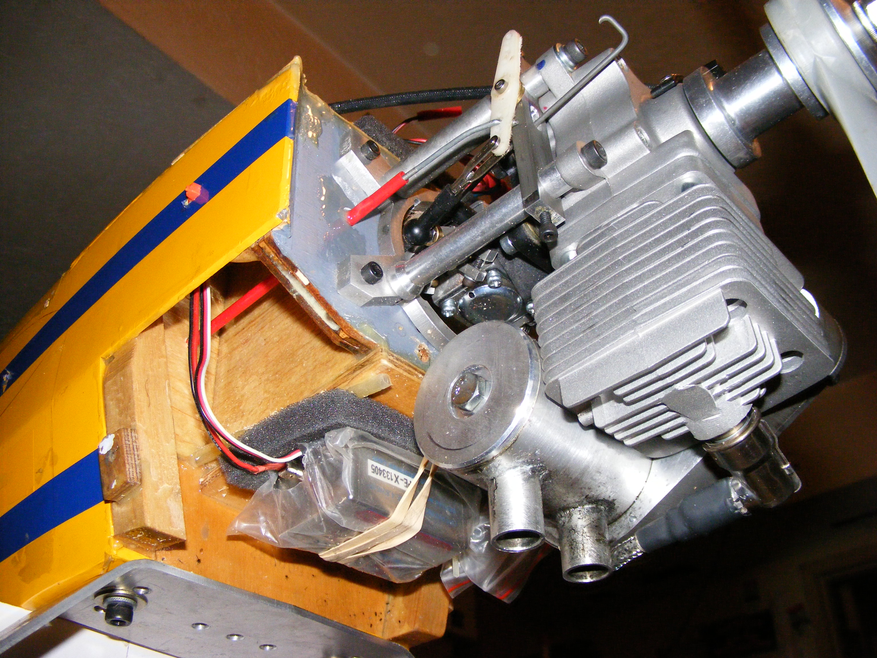

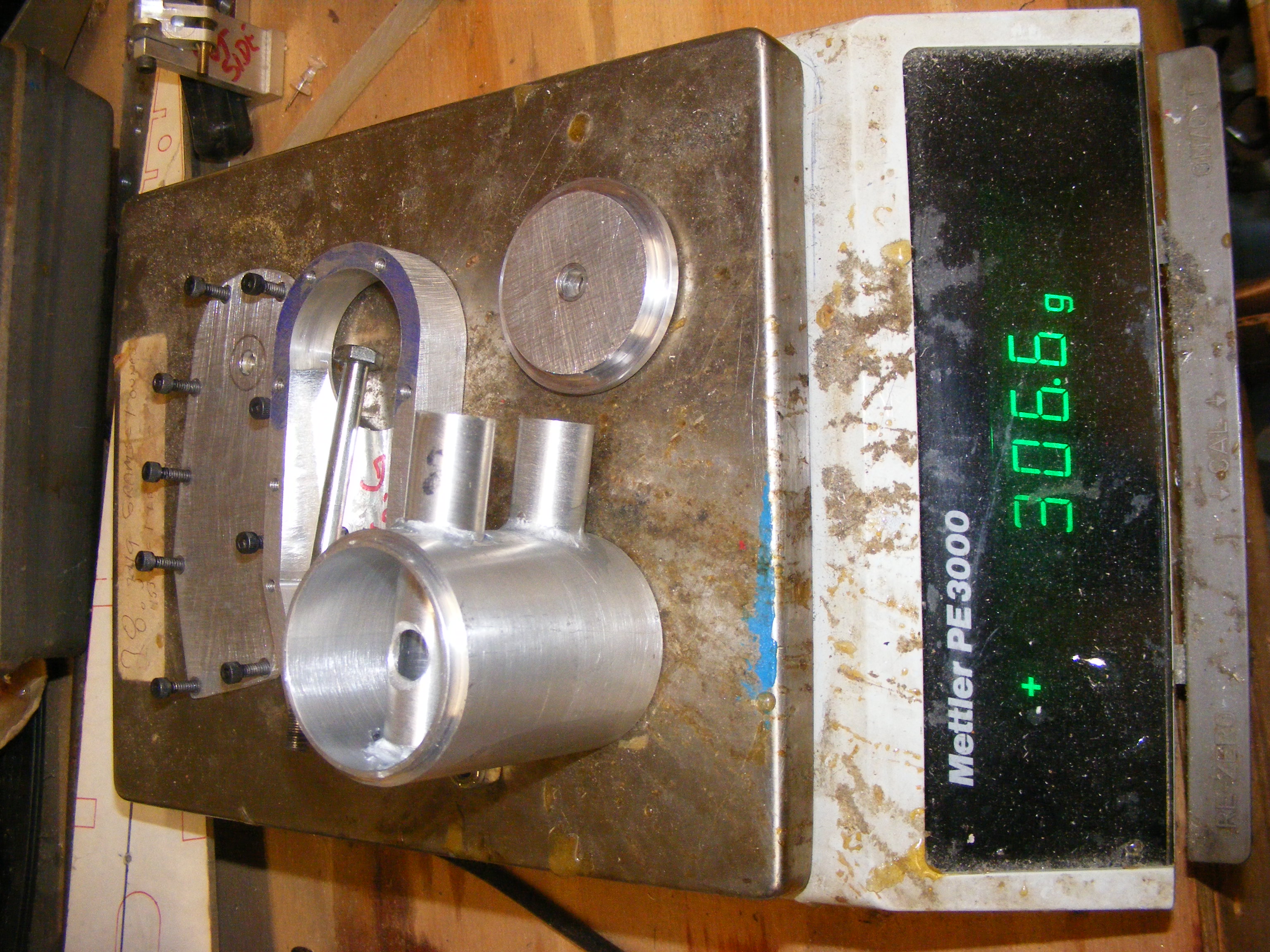

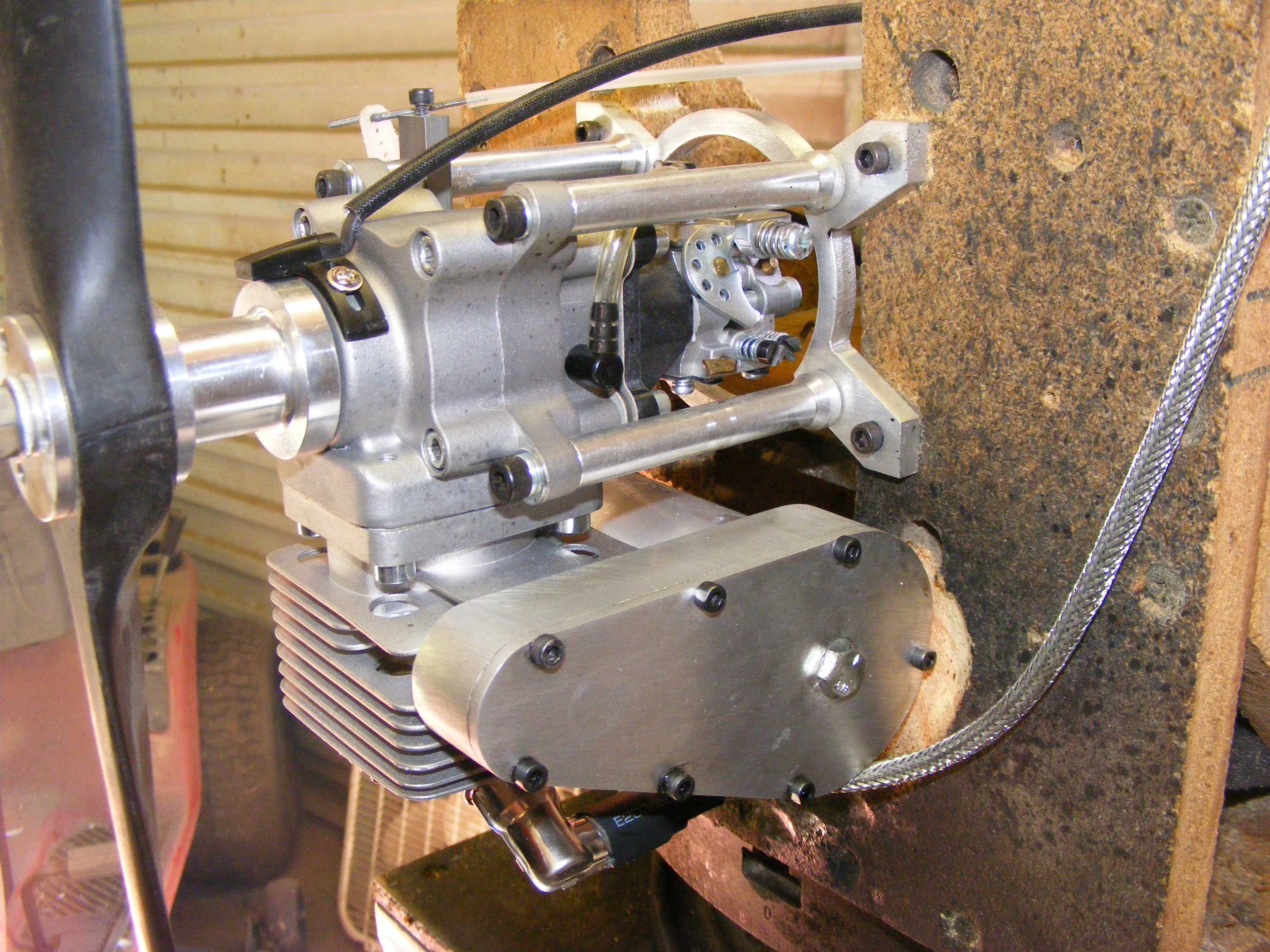

These pictures show a muffler for my RCGF 26 that has about 50 flights so far and has not came loose yet. One of the pictures shows a muffler on a scale but that picture is of a different muffler. I don't have a sound meter so I can't give any readings but I'm happy with the results. The round aluminum tubing is electrical conduit and has a 1 5/8" inside diameter. It takes about 8 hours to machine these parts. I'm using 5 MM screws about 3/4" long to attach the header to the crankcase and then 6-32 screws to bolt the 1/8" thick cover on. The 2 exhaust pipes are 5/8" diameter about 3" long and have a 1/2" diameter hole drilled threw them. They are welded to the conduit with that aluminum solder you can buy at Ace Hardware.
