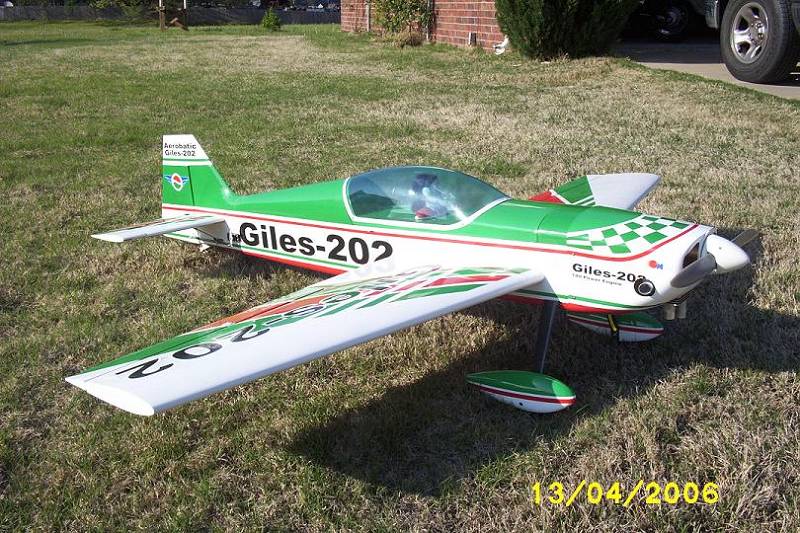

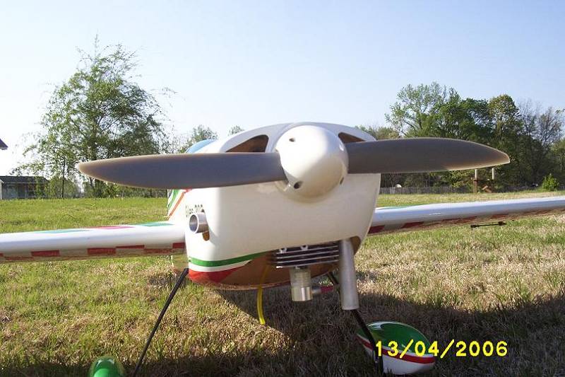

I would suggest a Brillelli 25gt w/ei that weighs only 2lbs 12oz and spins an APC prop 18x8 at 8000RPM generating 14lbs 4oz thrust. I have this engine installed in a Giles-202 that is rated for the same size engine as your extra 300. My Giles showed a weight as 10.5 lbs with a 120 size glow. My total weight came out to be 11lbs 15oz with this gas engine. My wing loading will be 28.5 oz comparied to 26oz with the 120 Glow. Here are a fer pics of this plane with this nice gas engine. I have not flyown her yet, but I know she will fly very well. Cost is only $265.00
goto www.brillelli.com for a look see.
Another possiblity is the BCMA-SPE 26 that weighs only 2lbs 4oz complete with muffler and EI. www.bcma.com Click on the BCMA-SPE engine This engine is only $250.00
