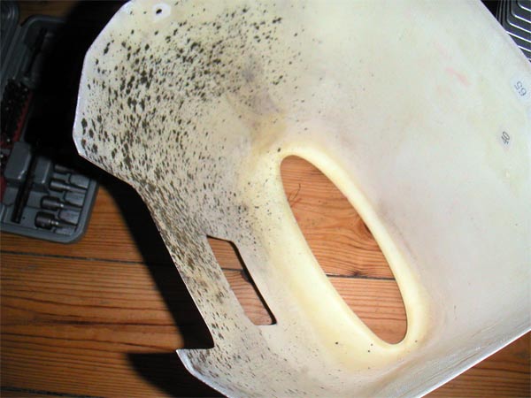

Gas engine mess during breaking in, is this excessive?
Joined: Mar 2005
Posts: 361
From: Copenhagen, DENMARK
About ½ gallon through so far...
Just wondering if the mess it makes is more than normal?
The engine, MVVS/Evolution 45, is running perfectly, however quite rich atfactory needle settings

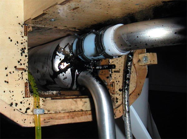

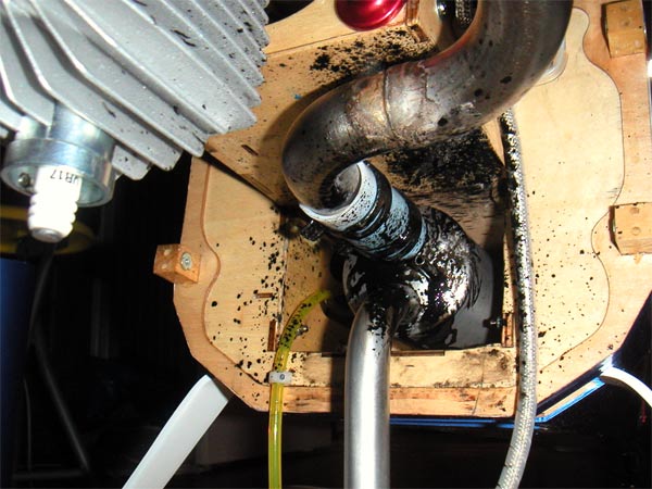

Doh! Yes of course - smoke fitting is now plugged.
However, the plane itself is pretty messy on the outside too. Even if the black goo is blown out the exhaust - would you say it's making too much black goo?
The engine is running perfectly, very strong and also very reliable and steady idle. I also has a nice smooth feel when turning the hub or flipping the prob.
Would you say the the amount of residue is ground for lowering the oil contents (currently running 3.3% as prescribed, normal mixture is prescribed to 2.5%)?
Or should I lean it a bit (still on factory settings, 4 stroking quite a bit)?
Or should I live with it for a while longer?

The amount of goo is never a reason to lower oil content. New gas engines have that bad habit.
It will pass. Just clean it off using plain gas, and you will be fine after a while.

It is a desired residue. The residue tells you that the engine as breaking in. Even if the engine is brand new, you can set the needles close to optimal, just not quite as close as when the engine has reached optimal condition. You should run the oil and contents that the manufacturer prescribes. To check if the L needle is set right, I will check the following. Does the engine have to warm up before it will take the off idle throttle? If yes, that's how I like it on an optimal engine, but not on a brand new. Does the idle get lower with time or does it have to clear exessively when given gas, it's too rich. Set the low, where it will take the gas immediately after starting, but won't take forever to clear out after 10-15 sek of idling. Then set the H needle to where the engine doesn't surge, meaning reaches max rpm, then goes down in rpm, but you probably won't and shouldn't use full throttle for extended amounts of time in the air when breaking in.
Don't feel bad about mentioning "factory needle settings". If the engine runs fine, as you said it does, there is no need to mess with the needles.

Probably,,,, as posted earlier, plug that smoke fitting (which would cure what is on the inside) and adjust your needles.

There's only two reasons for a gasser to be making big messes. Mixture too rich and too much oil in the mix.
Reducing oil is going up the downstairs.

Thanks for all the input.
First of all, I have plugged the smoke fitting. I will continue on the high oil percentage, maybe adjust the needles if I feel for it and otherwise live with it for now.

My Feedback: (15)
Posts: 1,960
From: Goldsboro,
NC
My Evolution 58 looks like that ( Not quite as bad but still dirty)and it is running the Mobil 1 at factory ratio. As soon as its done running their supplied bottle the Mobil is history. It seems fine but the residue is hard to clean.
Belray H1R much better!!!
Belray's HR-1 mixed @ 40:1 is known to run hotter and give approx. 15% less fuel economy than their MC-1 mixed @ 50:1.
Karol.
Karol.
Joined: Jul 2004
Posts: 869
From: Wisconsin Rapids,
WI
amsoil? Running the DA on it almost no mess but the Evolution? I heard someplace on these pages that it wont take the leaner mix.
