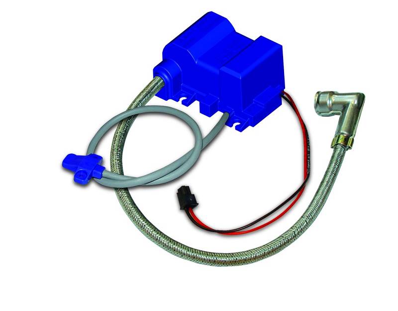

I have to agree with Jan not because i am a dealer but because i have tried this engines and they are powerful over there class and as well the new ignition that the company will start supplying the 45cc from now on (ICU-S) is coming with control of chokes servo for easy start , which as far i know is the first company who includes an automatic choke . For more information you can contact to the distributor of USA which is Morris Hobbies

It works perfect , Some pic of the new ignition
