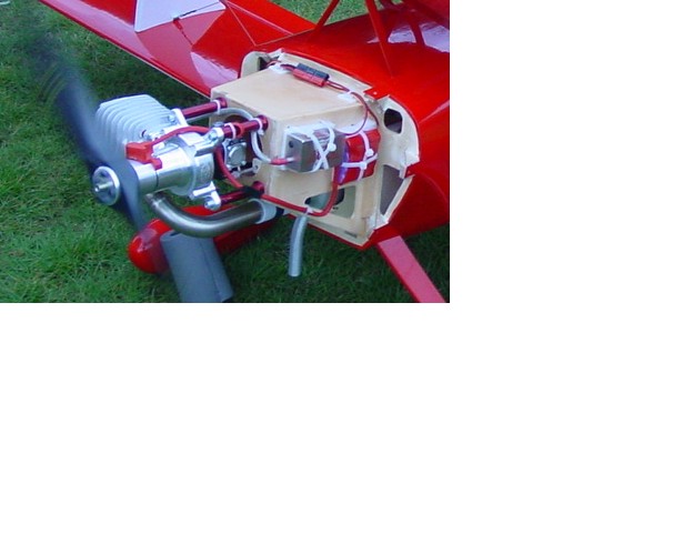

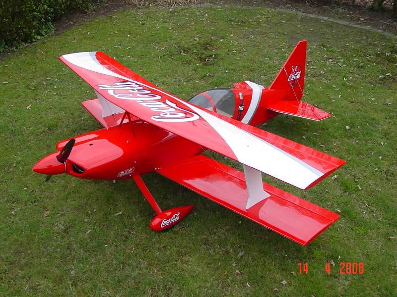

Need your help guys.
I'm flying a 73 inch ultimate with a DA50. Last weekend we had noise test at our club. The max. noise we may produce is 86 dB. My plane was measured a 95 dB. I have to do something about this but don't know what. I'm using a DA50 with a MTW muffler. For prop I use a 22/10 Mezjlik (carbon) and gives about 6800 RPM on the ground. I'm going to try to bring my air intake into the fuselage and perhaps a 3-blade prop but I don't know if it will be enough.

Measurement was at 7 meters. What do you mean with checking the inside ? It's a wooden frame covered with oracover and almost empty
. See the picture. Don't you thing that bringing the air intake into the fuselage would help. When my engine has enough gallons I will switch to a bigger prop. (Maybe a 21/10 3-blade). I will have to try untill I get to 86 dB.

This is an emhw Ulti? I have one as well. Mine should be <84db in 7m with 3W56 twin and engel 3blade 22x10@7100umin. Motor is soft mounted...
hints:
Make sure the wing cords are tight and attach felt (or something like this) to the wings and the elevator. Another noise source is the upper wing canopy since the steel staves may get play and produce noise.
hints:

1) Really tight wing cords are mandatory, at least for the measurement since the get loose over time. If they get loose noise and servo gear slop is the result.
2) Apply all this felt stuff.
3) Soft mounting of the engine could be required. However from the clearence of the DA to the canopy that I've seen in some german forums I doubt that soft mounting is easy.
4) In your pictures I've noticed that you have 2 cannopy screws only. This could be another noise source.
It is a difficult but not impossible job...
