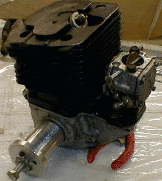

hey guys i aquired a used chain saw engine thats been converted to glow, looks to be about a 5.0 c.i.
need advice on what fuel, oil ect.
would really like to use this on ziroli corsair but would also like to make sure its going to be reliable

eagle: Tell us more about the engine and or post or email a photo of it. Then we can help you out more. Thanks Captinjohn

here is pic of engine
glow plug where spark plug used to be
no mag, no flywheel

Methanol and Klotz works well, we use 6% oil in out racers, but a sport engine doesn't need that much...I would think about 3 or 4% would be fine..Nitro is not needed.....We have run the SAME glow plugs for the last 2 seasons, they're still good....McCoy #9 plugs, 289cc engine, 9000 rpm......
Engine looks like a Quadra 80 with the crank reversed..Probably easier to make a mount that way.....
