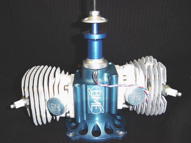

Does anyone have any pictures or a link to a BME 100? I am trying to figure out what Echo engine the cylinders came off of. I want to put big bore cylinders on my 61cc twin Echo. I was told the cranks were the same.

Here is a picture labled bme100.jpg by bme. The emblem on the engine says 102. As you can see, the intakes are blocked off to accomadate reed operation. Many of the 50cc size Echo saws have the crankcase intregrated into thr saw body.

You best bet is the get ahold of Keith at BME or Kris Welter in NC.
Both should be able to give you answers to your question
