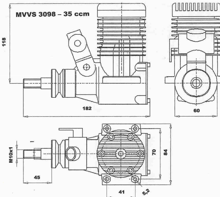

What do you think of this motor? I am still looking for a beam mounted motor to put in a 20 lb Spi.tfire. The inside of the beam is 2 3/8 in and that is cutting some of the beam away. Thanks Rich

They start easy and run great. Lots of power.
