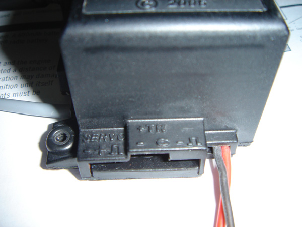

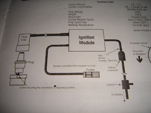

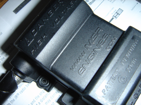

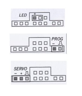

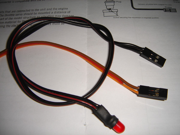

I recently purchased an Evolution45. I am having trouble with the wiring. The manual has only one wire for the battery to connect to. That is simple enough. However, my ignition box is different than the box that is most commonly seen with the evolution 45gx motor. The ignition i received was the TY 2 Ignition. Its sold on Horizons website but i cannot find any tech support for hooking the wires up .
In the pictures you will see the different places for the wires to connect. It came with 2 wires seperatly from the ignition and one wire comming from the ignition that is not removable. The instructions say that the battery is connected to the orange/brown wire comming out of the ignition. Ok, simple enough, but i have no idea where it might go. If that is the case, the plug on the connecting end is male. It would need to be female for my JR switch to connect to.
The wires connecting to the ignition box each only have a 2 wire plug. One is the orange/brown and the other is a light... i guess to put somewhere for an ignition power indicator light.
From the pictures below, you will be able to see what i am talking about. Im thinking about just ordering one of the other ignitions that has only one wire. This is my first gas motor, so all of this is new to me.
any suggestions or help is appreciated.

I think you got the new MVVS 45 - lucky you! Unfortunately, I can't help you on what to connect where.
But my bet is that one of the plugs are for a choke servo. The new MVVS version automatically controls choke and will choke your engine during starting and during idle. This should make it possible to run the engine at an incredible low idle.

Yep you did... wanna trade with the old Evolution 45? Almost broken in and MUCH easier to install the ignition.
Look at the plug to the left - that's for the choke servo. The other 3 must be for the probe, LED and battery.
Please let us know how the auto choke works once you get it startet.

http://www.rcuniverse.com/forum/m_36...tm.htm#4364801 You can look on my post for some new ignition , maybe will not be so helpful though.
some advises is that you use a six cell batteries 8.4volts , the range of the new ignitions are 6-8.4 volts. you have to connect your batteries to the wire that is coming out of the ignition and the lamp you have to place it at the top slot , the lamp is going to giving you some signs of your batteries power. when your bateries are full charged then when you switch on the ignition then is going to light on and off 2 times and then is going to go off that means everything is OK to start and you have fully charged batteries. when you use 5 cell or most probably when your batteries are almost empty then the lamp is going to be on all the time you will be able to fly but once your engine is off the ignition will not allow you to have another flight. and if you put less cells of 5 , for example 4 cells then the lamp is going to be lighting on and off all the time that means no chance to turn on the engine you don't have enough voltage
Last thing at the place where it says servo there you should use a standard servo and you should connect it with the choke of the carb to regulate so that your engine functions better at low rpm.
I hope that i have been helpful.
Regards Eftychios.

There has been a update to the Ign. setup on horizons site The suppliment that cam with my Evolution 58GX-2 was incorrect for the programing. here is a link to horizons bulliten :
http://www.horizonhobby.com/Products...odID=EVOE58GX2
Im currious as to what voltages you are seeing for this ign. to show a battery to low state?
I was unaware of the choke being actuated after the engine had been started
im attaching a pic of the wirring setup that came with mine might help a few with out this wiring setup.

The new ignition module from MVVS has a different power requirement:
ICU - L (Light) 6- 8.4volts
ICU - S (Standard) 6 - 8.4 volts
ICU - P (Professional 9 - 13 volts.
Good input on the MVVS Support thread.
