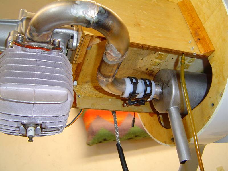

I talked to Bobby in great length about the canister set up. He said the mount on the canister is critical. If it's too firm the header will break. I made up a support from plywood/tubing, but just wasn't satisfied with it. Seemed a bit too rigid for me, so I used the mount that CA offers.
I have similar set up with my canister, like your pic.
After talking with the welder, we conclude to not install the clamp on the teflon coupler. This would give a little play (1/4'') between the header and canister inside the teflon coupler for header expension.

Default RE: ideas needed for broken flex header??
Looks good.
On a gas engine, the teflon coupler will float anyway on the very hot header, with or without the clamps.
The end of the muffler must be restrained, so it cannot move backward.

ORIGINAL: preivers
My canister mount must be snug enough to keep it from sliding back. I don't have any kind of restraint on the rear of the canister, I'm using the spring type clamps on the teflon coupler on the header and the canister, and it hasn't moved in 85 flights.............

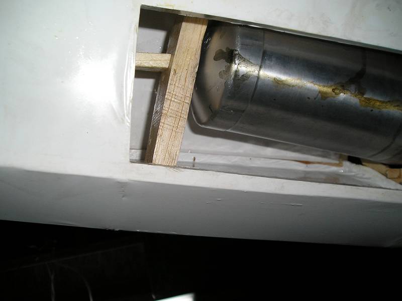

here is what Pé means
All my canisters installation moved backward without that.

That's it, though I would prefer something springy like a silicone O-ring or something to avoid any rattle and muffler dings.
That muffler rear is right in the exhaust gas blast, so the rear wall gets very hot.

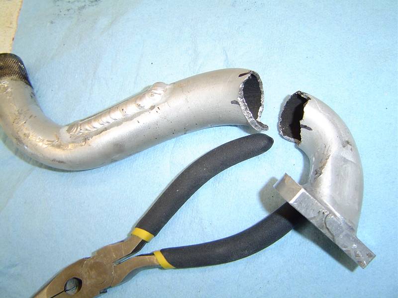

ORIGINAL: Scoubidou
The KS SS elbow is so thin, i think it's not recommended for a single 80 CC engine.
Ok Scoub, Now you got me spooked.[X(] My aluminum header broke on my 3W80Xi yesterday. I had 85 flights on it. Some other guys broke on like flight 10 or so. I actually thought I was in the clear.......I had the KS parts here, so I brazed( ?) them up with a propane torch and the rod that AI sent me. I'm going to fly it tomorrow. Hope I have better luck than you. The reason I didn't use the KS first was I couldn't keep it in the cowl. [>:] Working on these headers/canister set-ups is starting to test my patience.........

Your aluminium header seems thicker than my KS (1 mm). It may explain why it last 80 flights. The new 80 engines are stronger but we must upgrade the header too.
I am talking with some IMAC fliers here to find another solution.
The aluminum is thicker, but the SS is much harder.
I know what my solution will be if this header breaks. A side dump muffler! [&o]
