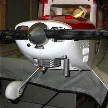

Old 08-25-2003 | 10:52 PM
My Feedback: (27)
Joined: Mar 2003
Posts: 132
From: Melbourne, FL
Default Tcraft engine FPE!!
Here's mine with the FPE 2.4 in it. Looks and flies great!
