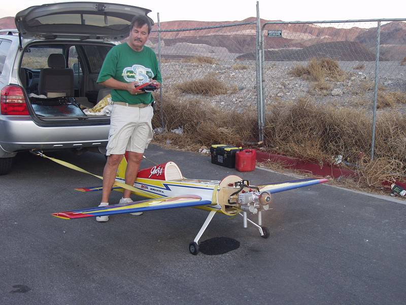

You can get a pair of 12 foot long, 1 inch wide adjustable cargo straps from Wally World for $5.00 IIRC, and you can attach those to a pole or anything solid, I've even wrapped one around the rear tire of my Jeep. You can use additional foam around the strap where it fits over the tail if you want. I was taught to restrain models in some way right from my trainer days, and on one particular occasion it saved me from being eaten by a 110 size glow engine spinning a 16x6 APC prop at 9000 plus RPM. I'd forgotten to change the model in my tx and the throttle servo had reversed travel, so it went to full power when it started... [X(]
Two things to keep in mind; you must make sure the strap doesn't cut across any control linkages or delicate parts when you put it on so it might run over the top of the fuselage or the bottom. The other thing is that I only use this for starting and usually do power checks like a lot of guys, standing over the fuselage with a leg on each side of the horizontal stab. That works for my 50 size gasser, but the 100 size I always ask someone to hold when doing power checks. The gassers can damage the tailfeathers if you do power checks with just the strap holding them. I've got a friend who taught me the cargo strap trick find out the hard way about running power checks on an 80 size gasser he'd just built and only the strap holding it, then he had to rebuild the tailfeathers.
Either way, even if it does get away from you and damage the tailfeathers, it WILL keep it from damaging you... [8D]

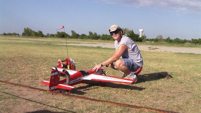

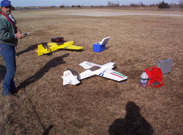

I will make a call tomorrow to the local hobby stores around here and get the contact info for a killer tail stand many of us use here in the Okla City area. It has a 3/8" spike at least 12" long that is pushed into the ground. The padded horizontal stakes are curved to keep the tail down until your ready to taxi. To release your plane simply pull the plane backward a few inches until the stakes clear the tail. They automatically fall down and you can taxi right out of the stand.
Maybe someone will see this before I can make the call tomorrow and post a website or phone number. But I'd even be happy to make the buy and ship to those that need it. About $35.00 is the going price if I remember right. Had mine for over 3 years of heavy use.
As you can see in these photos they will accomodate planes from 25 size to giant scale. The largest I've witnessed was a 40% Sukhoi.
And if a big twin gasser can't budge it ,,, I'd call it it foolproof.

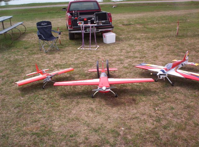

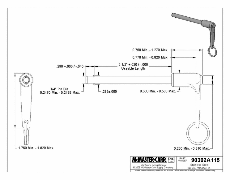

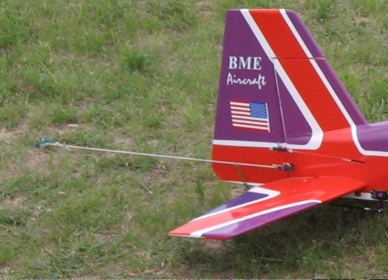

I've watched Kurt's restraint system, and the other guys that use it. These work pretty well. There are only two drawbacks; One - you must be able to drive it into the earth/surface. Two - it transfers the FULL forward-pulling load to the leading edges of the stabs.
Airplanes with removable stabs and stab-tubes get a LOT of stress this way, and I've seen lots of structural wear from the nylon ropes/straps/webbing.
Another system that works is a "shear pin" restraint, where a "push pin" is inserted into a tube crossways in the fuse, usually installed at a junction of vertical side/formers/bulkhead, such that the "load" from the pin is distributed on the sides of the fuse/plywood internal crutch.
Works very well, if you remember to loop the rope from the pin over the stake
(forgot that once and got a belly full of an Ultimate with a 3.0 Fuji at full throttle. Wasn't pretty.)
Pics attached of 30% Yak restraint. Pin example (there are MANY like it) from McMaster Carr.
(forgot that once and got a belly full of an Ultimate with a 3.0 Fuji at full throttle. Wasn't pretty.)Pics attached of 30% Yak restraint. Pin example (there are MANY like it) from McMaster Carr.
