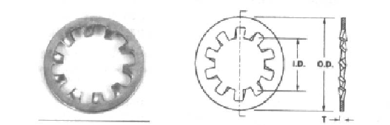

Default RE: How to keep muffler bolts tight
Vibration proof lock washers. They worked for me.

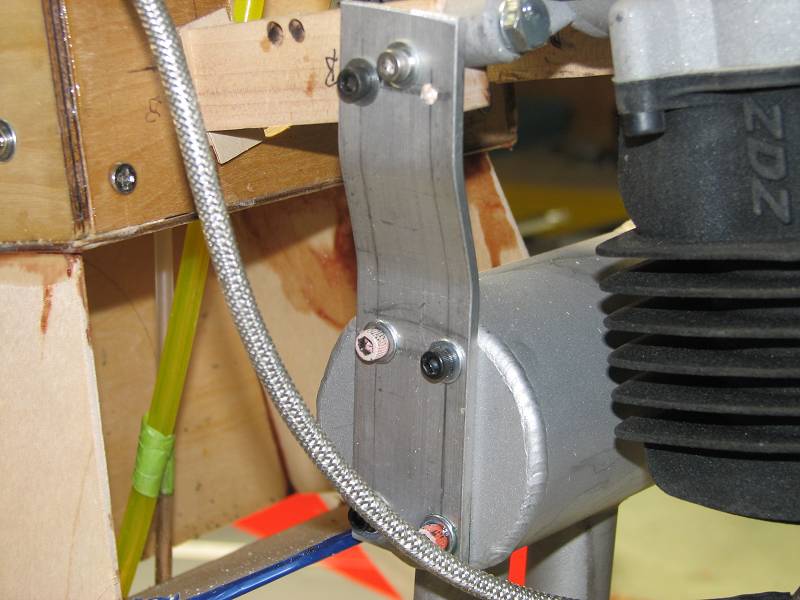

here is a little removable locking bar I came up with
The 5mm bolts slide easily thru 5/16" holes -- and the set screws are 6/32x 3/8" cone (pointed end).
so - tighten and loctite the bolts into the engine -- then drop the bar in place a add a dab of loctite to each set screw.
their job is to prevent rotation of either bolt .
a dremel disc can make a tiny dished spot on the bolt head for a solid engagement of the setscrew

None of you engine guys ever have to repair an engine with the flange beat to a fair thee well?
a perfect mating surface is ideal of course but not the rule rather -an exception
I don't like permanent locking setups as they can lead to breakage by the overly enthusiastic types
The major muffler problems I see , are from those who use large engines and the in cowl mufflers - not supported at the far end
the cantilevering simply stretches the attaching bolts if vibes are right
So
I like to support the far side of the can directly to the engine NOT the firewall- then use a mor standard thin gasket firmly seated .
here is a rather simple jury rig - where a mounting flange was not provided- may seem unnecessary to some--- but years back -- I fought my way thru those wretched four stroke engines in super light pattern planes -and the mufflers broke off -headers cracked apart -on an on-- due to the long cyclic period between power pulses - actually about the same seen on our gasser engines.
If you solve the loose muffler thru locked in bolts --I bet you end up seeing the muffler come apart -eventually -unless you resolve the real problem-- unsupported mass.
The stand off in the pic shown are boxed togetjer on top and one side-as stand offs in general are just asking for trouble from the possible twisting of the engine .
Smaller engines don't have as much of a problem but 60's on up will -especially if th Pits type is a larger can - these perform much better than the restrictive ones but I think - full support is a good idea

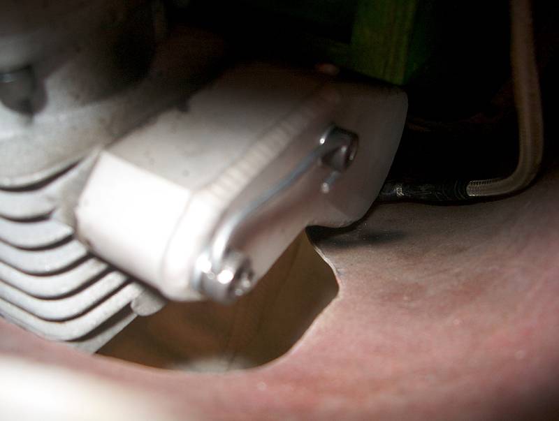

I drill out my bolts and put a bent piece of wire in to keep them from turning out. Works for me.
I also ditch the gaskets and put a light smear of the permatex ultra copper gasket in place.
On some mufflers the bolts are recessed so you have to rely on some type of lock tight goop.
I use permatex ultra copper gasket on those, and the lock wired ones. No problem, as mentioned clean the bolts first, I use paint solvent.
Nothing like watching 150 bucks of muffler disappear into the weeds, anyone been there

Flip and Fly:
What you've done in that picture is safety wiring.
If you want to make it better, take that wire out of the back bolt and run the wire UP from the bottom. That way if either bolt tries to loosen, the wire stops it and pulls the other bolt tighter.
