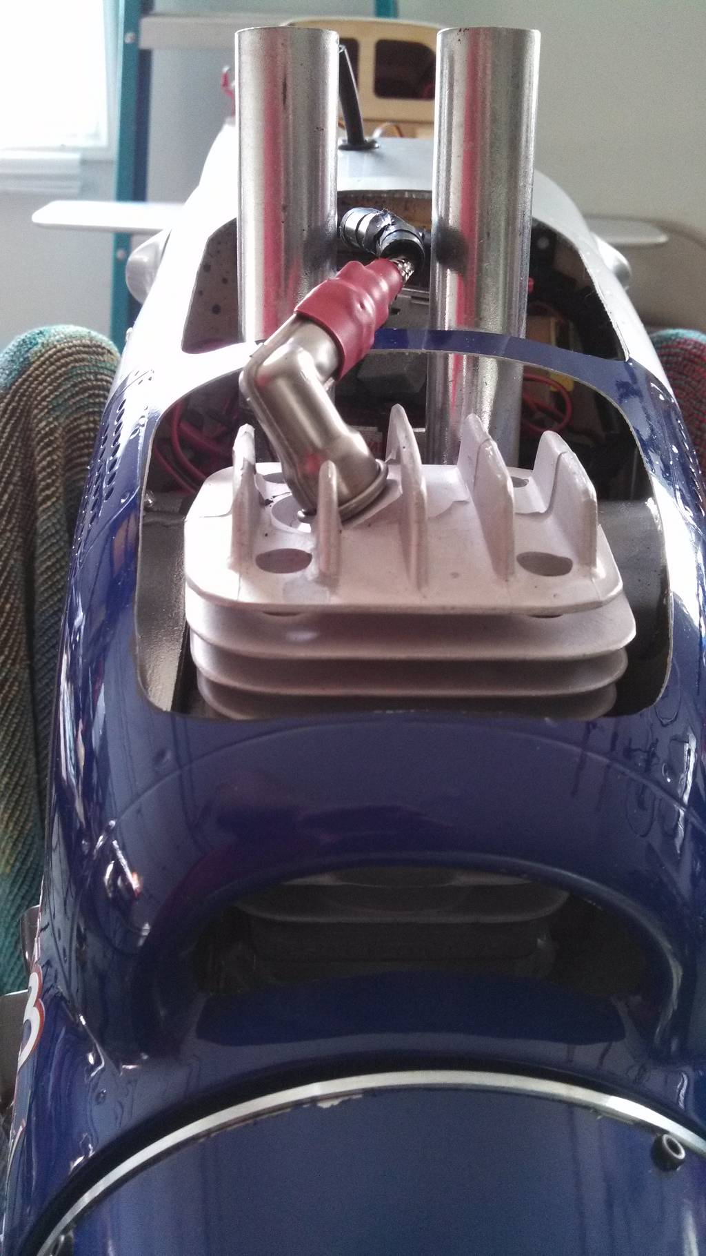

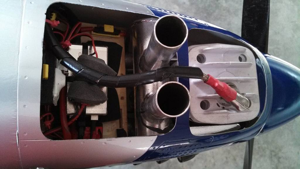

Help
I am flying an Aeroworks P51 with a DA50, Jtech Pitts muffler, Xzoar 20X12 prop, RedLine 40 to 1 on reg gas. Engine runs great for about 5 minutes then will lean out overheat and die. When I take off the engine is slightly on the rich side and as the flight progresses it begins to run stronger (leaning out) and then will quit. I know a gasser shouldn't start out the flight rich and go leaner like a regular 2 stroke non pumped nitro engine. I checked out the plumbing and clunk in the tank and its perfect. No leaks. I pulled the carb apart and the screen looked dirty and I removed it and have been flying it without the screen. The problem worsens when the ambient temperatures get hotter. It's overheating. I have the cowl opened up as much as possible. I flew it 3 flights Saturday before noon and no problems then afternoon temperature increased 10-15 degrees and then it started acting up again. I have lots of experience with DA100 & 150 and have never had this problem. Any ideas?

If it's an overheating problem, then you should consider ducting on thefront side of the engine. Ducting should start at the chin cowling edge and get as farback as the first 1/4 of the cylinder; further back doesn't buy much but too far fore and air will leak around the fins andbecome ineffective. You want to try to eliminate any free air passages around the cylinde, head and crankcase.....
Ductingdoesn't need to be elaborate. I use 1/32" balsa sheet which I often will build up in situ, to guide the ram air directly onto the fins. I've used cardboard stock before too. The sheeting could actually touch the fin edges or it can be 1/8" away...it will be effective either way as long as it steers the air into the fins. Just as important, the hot air discharging from the cylinder needs a clear path to the exit holes.
The exit holes don't have to be huge either but for most effectiveness, you want to put a short dam in front of them creating an area of air deflection. It creates a slight negative which draws air out of the cowling. This is similar to the lip that's raised in the front of amoon roof in a car.
I've described this with photos in my Derivative thread in the Pattern Forum. Very effective in hot ambient conditions.
Thanks MTK for the advice. I've attached pictures of the cooling area on my P51. Would you put the air dam at the very back of the cowel or on the cross bar just behind the cyl head?I really believe it's a fuel draw issue but haven't been able to prove it yet.

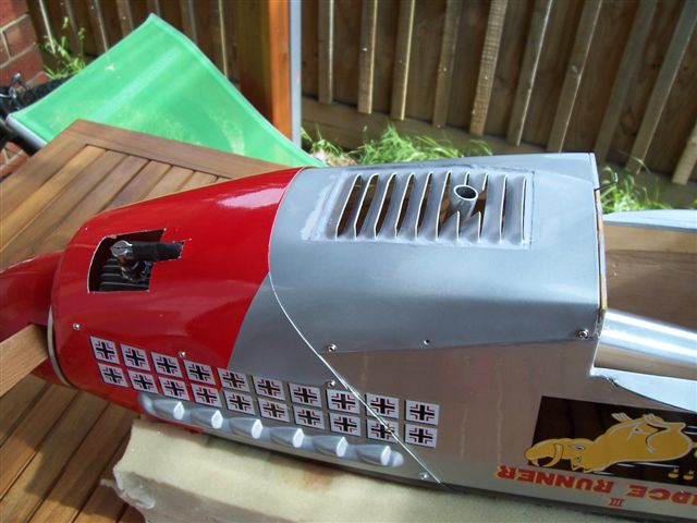

is there a cool air supply to the carb at all? If not it could be just recirculating hot air coming off the cylinder. Poor fuel draw usually shows up as hard to start on a gasser as even with the choke it will be slow to draw fuel. How many flips with the coke on and cold engine does it take to get her to pop? My DA 50 would usually pop between 6 and 8 flips. Remainer of the day was choke off and 1 to 2 flips. It may be that the clunk line inside the tank had dropped off or has a split.
Interesting you mention the carb air. I have been thinking this may have something to do with it. As near as I can tell it's recirculating hot air and I know that can't help horsepower. The clunk is perfect along with the lines. It will usually pop cold on about 6 flips and then start in about 3-4 flips. If I could get clean air to the carb it might help. Maybe the little spoiler mention in a previous post would help this. I guess I need to experiment with the air dam and see if this helps. I appreciate any and all suggestions.Thanks.Mark
You need to create negative pressure to draw air from the cowl, also baffling around the side of the cyl. You don't want air to flow around the head, it needs to go right through the fins. I use a foam type material CA glued to the cowl. At the hardware store you can buy aluminium vents, they are perfect for creating negative pressure.
Hi Mark,
I had the same problem as you with my TF P-51 with a DA 50.
I think these type airplanes have good enough air flow past the cylinder head.
The problem I think is the tight cowl up by the carburetor.
I didn't like doing it .....but I took my Drimel tool and made a small narrow slit on top of the cowl to force air down to the carb.
I also have between the engine supports a sheet metal air dam zip tied to keep the muffler heat down.
I went back to DA factory needle settings also that helped.
It work for me.
