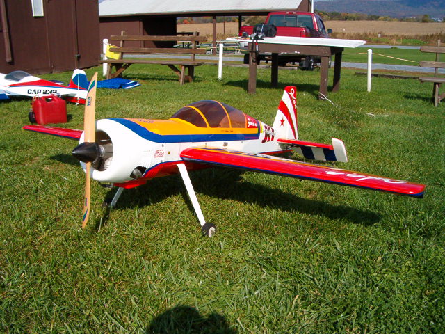

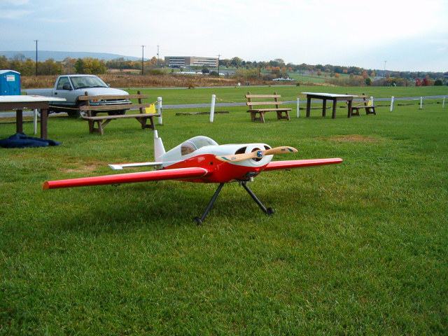

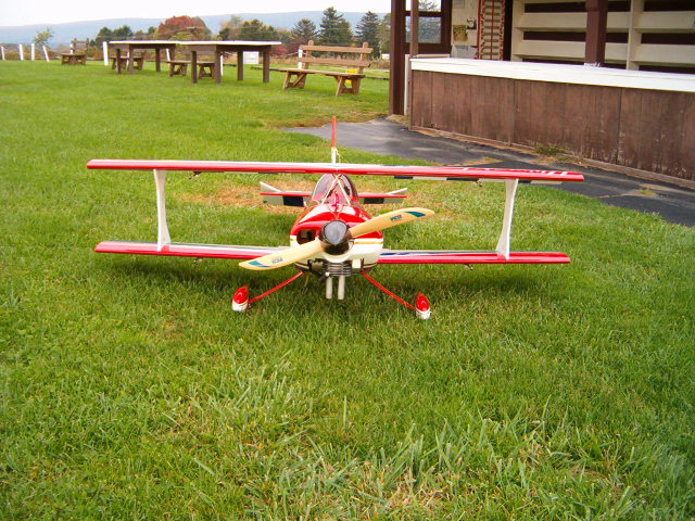

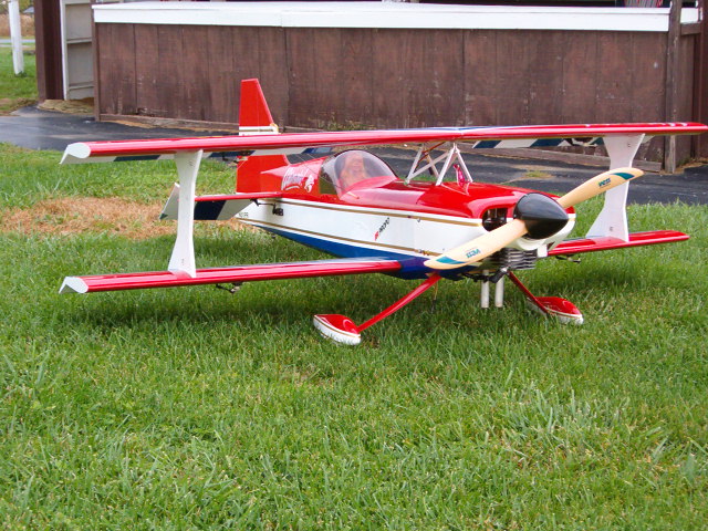

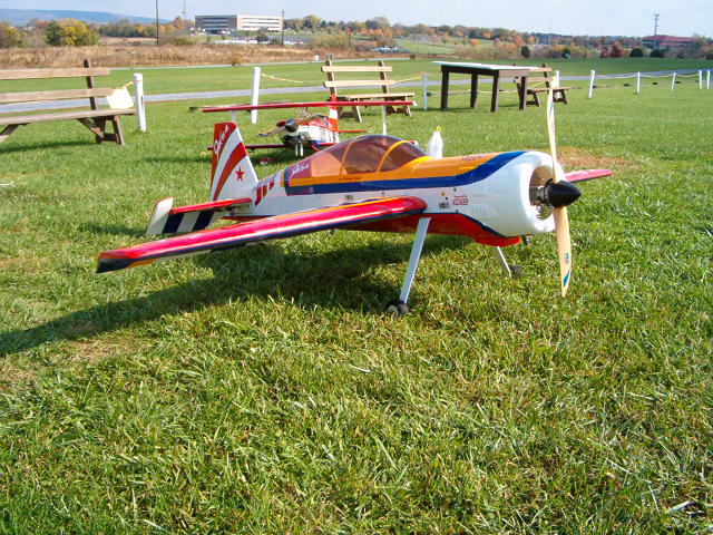

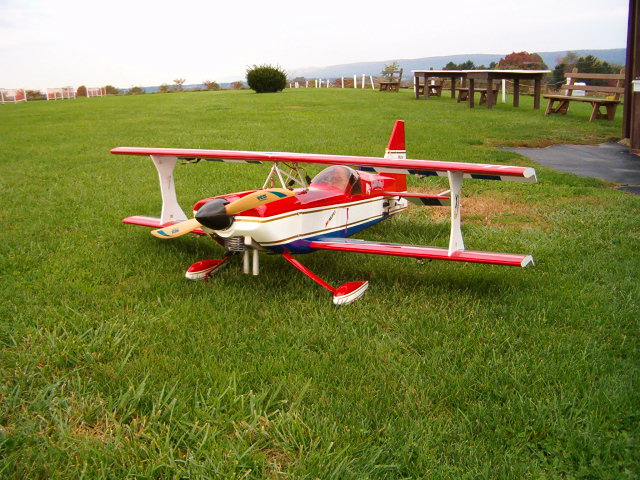

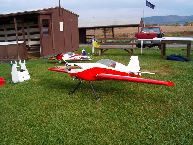

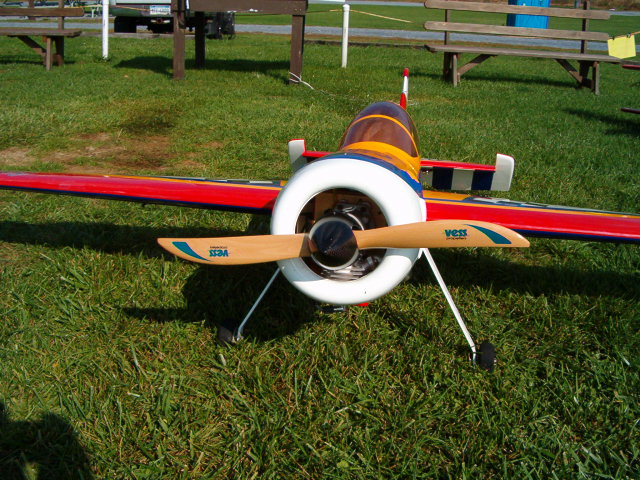

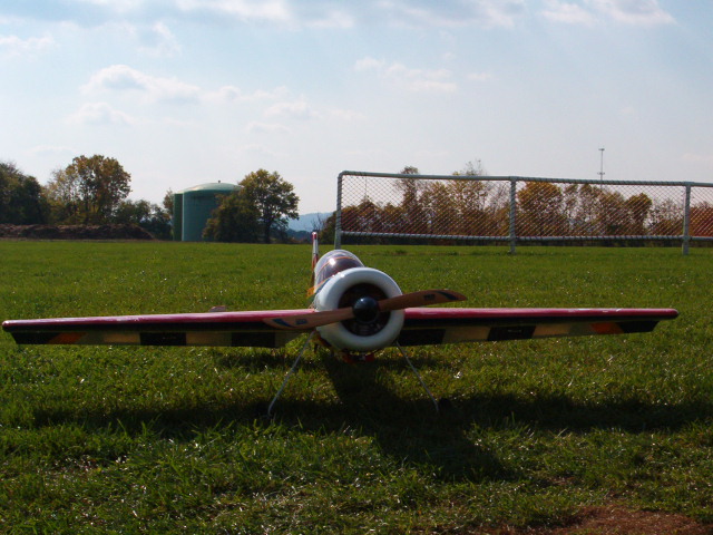

The Yak is 19lbs and flew with the Vess 23B on it and I like it a lot. Much better on this plane than the PT models 23X8. Here are some pics of the Yak and Ultimate with the prop on it. whaturi was also there to do the maiden on his WH Giles 202 and I gave him the Vess 23C to try it and he loved it as well. I'm working on a video of his flying with the Vess on it, which is powered by a MVVS 58cc. He got this plane down to just over 19lbs
