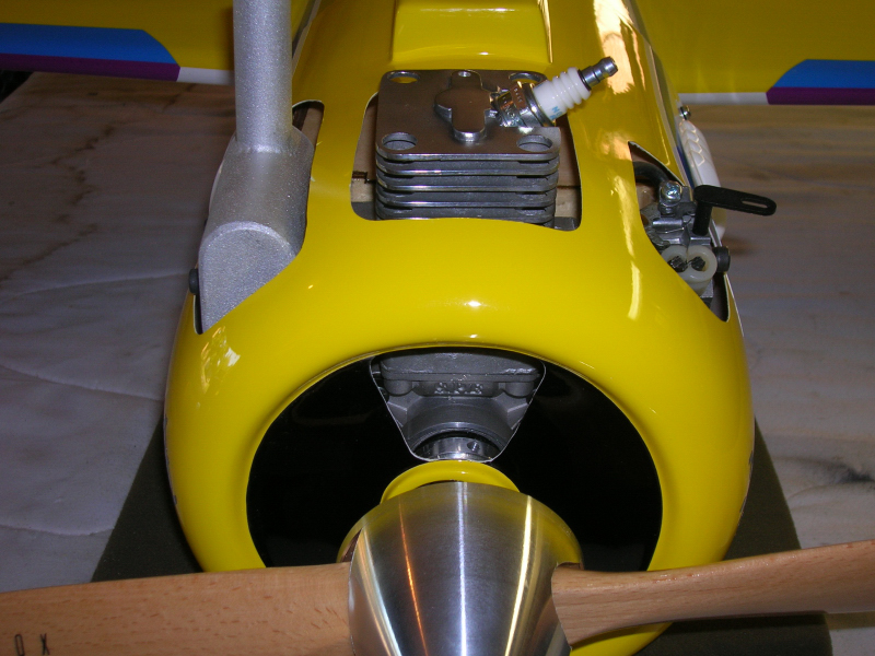

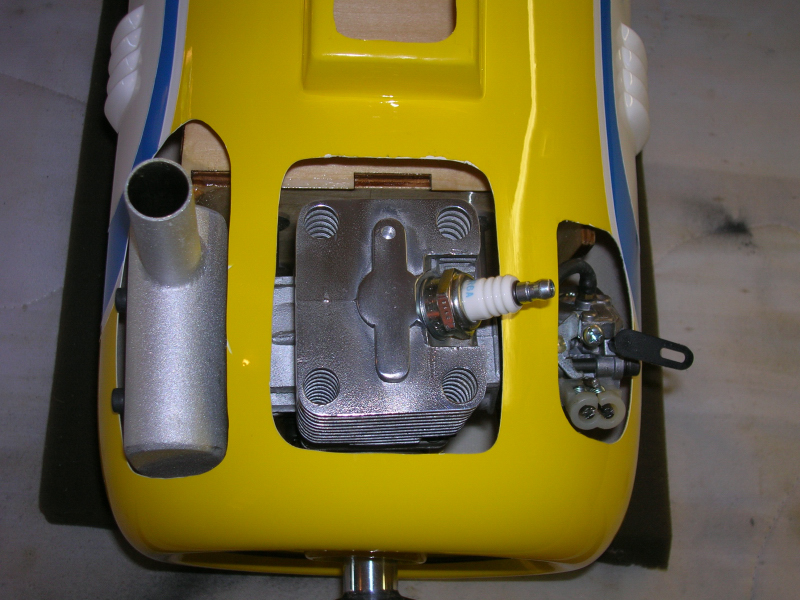

Hello, I have currently been building a Yak 54 with a 40cc engine. I am having trouble figuring out a way to make a good template for the cut out around the engine. I will show a pic of another but similar airplane and engine. I don’t want to screw it up so I am looking for any ideas on a way to make it easy. Thanks

well measure a square around the engine itself.
They draw the square on the cowl. Make it smaller then it should be then put the cowl on to see what more needs to be cut and expand teh sides that need to be cut.
Hope this helps..

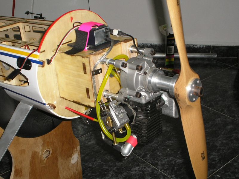

To do it exact is a pain.
Install engine and then a piece of card board attach to the fuselage.
Draw the outline of the engine and muffler on the card board.
Remove the engine and install the cowl.
Remove cowl material where it is outlined on the card board.
Re-install engine and installed modified cowl.

gapple12,
What Geistware posted is what I do. Start with small holes and cut a little at a time. It takes a long time but the end result shows your effort.

I didn't baffle the front of the cowl, it came that way. All I did was make the cutout for air to pass over the engine. You have to be careful not to have to big of an opening because you could get to much air coming in and no place for it to go out. Some times guys will block the front of the cowl off if they are having heat related problems but I want as much air as I can get passing over the engine with the smallest hole that I can get away with. My QQ YAK 54 73" has not been flown yet so I don't know if I have a heat problem or not. I shouldn't have with the head of the 40cc and muffler exposed the way it is.

I do as Geistware suggested but I use clear plastic sheeting (window/windshield material purchased at hobby shop) instead of cardboard.
