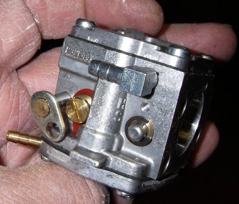

I'm in need of a little insight, from those of you with experience as I have very little exposure to gas engines in our hobby beyond a converted G26.
I have a new 3W80xi, upon unpacking and inspecting it I noticed in the casting of the head, near the base of two cooling fins there are a couple of casting imperfections which have left small holes, a few millimeters wide, in two different spots.
In the fin itself I would think nothing of it, but since this is at the base of the fin, along the outer cylinder wall, I just thought I would ask all of you with experience if I have anything to worry about.

The location and size of casting holes can be important - or of no consequence - If possible a clear high resolution photo can be very helpful (example)

Hey Guys, I posted the original comments for help. Thanks for the replies thus far. I did the best I could with a few digital pictures. Please see attached and let me know what you think!

That one-- I would expect you never have a moments trouble from it
whre the problem really exists - on engines -- is when the porosity and some folded casting flow linesor voids show up around the base of the jug - the mounting points can fail .

If it is a gas inclusion bubble with smooth walls, nothing to worry. If the bubble walls are grainy, it may be different, but it is not a strength issue. I would advise to notify the importer, check the jug inner liner and just run it if the importer agrees with that. If the metal turns out to be porous at that spot, it will show up soon enough, and the importer will be the man to contact first. He will be in touch with the factory about the items he sells, and may set you up with a replacement.

Just an FYI for anyone that has followed this little thread, once Bobby got a digital picture of the casting imperfection, he's replacing the Cylinder, no further questions asked.

great service! To me it looked like a smooth , small gas bubble - I would have run it first -
