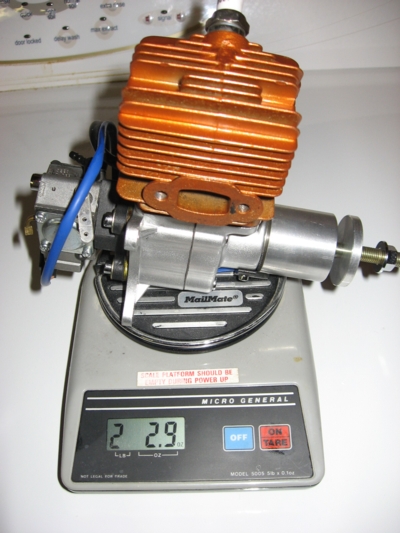

You might want to try one of these. I've flown a Seagull Super Star that had one in it, I think it would power your plane perfectly. Great price too at $295
http://deakraus.bizland.com/ls26cc/
