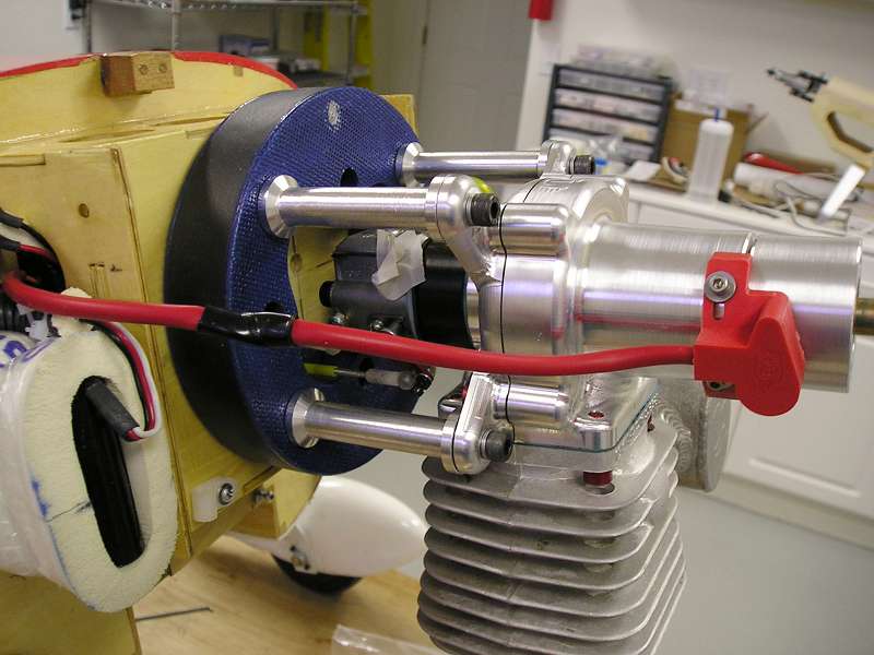

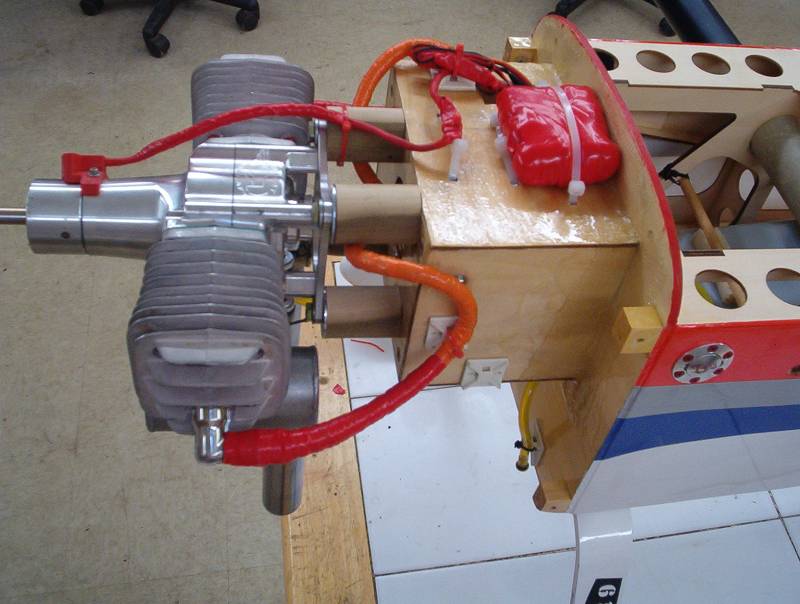

hey guys has anyone got a picture of a wooden mount. Id like to see the maple mounts you talk about dick
Cheers
kingsley
Old 02-12-2007 | 10:01 PM
My Feedback: (54)
Posts: 701
From: Four Corners
Default RE: Soft mount for DA engine
Here's the Hyde mount. Member Slyder (I think) is the owner of the model. Or was back in the day.

I use 1" ash dowel stock from Lowes.
