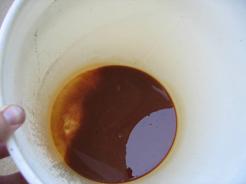

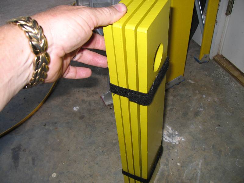

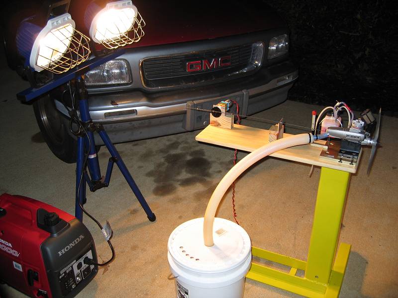

Had to build one.
http://www.youtube.com/watch?v=ygLLE9wypoA
Bill Vail
www.RCScreenProtectors.com
ID:	632467   Click image for larger version

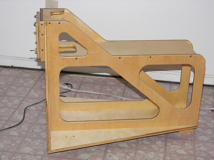

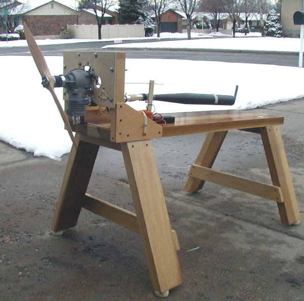

here are two types -that yellow one above is sure nice!
I designed the big one so all running could be done standing up and walking around it -
after a while, standing bent over to hold things gets really old . The table on the iron one is about kitchen counter height. It was really easy to make - all pieces are simply 2x2 iron - straight cuts with overlaps except for the mounting frame.
I hate complicated stuff- -so I try to do things I need, as easily as possible
Ed's stand is a work of art - designed to fit in a 323 Mazda-- really !
Mine fit in between the captain chairs and front seats of my last Chevy van. but real criteria included something which could be wheeled and parked in garage. the wheels only touch ,once the stand is tilted forward
I once did a magazine review for an engine which had a mid range (3000rpm) shake so severe , it made that stand skitter on the concrete ! It was a "conversion type engine that would only start n run with the head facing down- otherwise the plug never got wet -
What a beauty!!!

Ed made the wood one - from furniture grade stuff -I was surprised that the top wasn't matched Brazilian rosewood.
I would have used framing lumber ---at the prices for that stuff now -it is all I can afford . I used to pay 80 cents for an 8 footer. My first brand new home in 1967 - $22,000 --had all hardwood or shag carpet option ---same price - really -- and the underlayment was diagonal boards - squeaked pretty badly -I was always adding nails to fix squeaks.

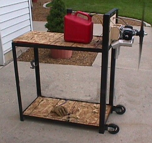

Here is mine. Simple and works with anything I have converted including twins. Tested many engines with it. Here it is attached to the grill with a big clamp. Yes it is safe and doesn't move the grill as it has breaks. Usually I screw it to a table top.

Now that's something I can work with. I was thinking of a piece that I clamped to my Workmate portable bench, maybe not so far off after all...
Mark

Here is a list of bullets in no particular order:
- Make it to a height you would like to stand and crank a finicky engine. Your engine is on a stand for a reason and may require some tinkering. It's nice if you're not flipping at eye level or kneeling to curb-height.
- Make it's as universal as possible. While today you are thinking G62, next week your club may start a killer class of 1/2A pylon racing you'd love to join.
- Make it stable. I don't mean stable like when things are going well. I mean stable when things go wrong. You will thank me the first time that Jett .90 throws a prop blade at 16,000rpm and the SOB starts shaking (shaking is an understatement).
- With big engines, weight is your friend... but make that weight removable. You won't use your stand if it takes 3 men and a boy to move it out of the shop into the yard for some testing.
- Make a provisions for a shelf behind the motor. Again your engine is on "the bench" probably because you want to work on it. That usually means a few tool and a good sized gas tank.
- Fuel proof it well. Making my first test stand in high school wood-shop proved to be the last test stand I'd make for 30 years. The yellow metal stand was the first new stand since 1978. Regular old polyurethane works well.
- You will need to make provisions for a big tank. Preferable 32oz. You would also like the tank height to be adjustable. Setting up your engine perfectly and setting the needles for your next big test flight means nothing if the tank is a foot to low.
- My first test stand was made of 3/4" marine grade ply and something of a box. In fact, was more like a speaker box. It worked well for years but it was loud. An open structure will serve you better.
- If you plan to do any testing over time, you will probably want to make provisions for a goo collector.
This is just a blast of the first few things that came to mind. I'm sure there are more. I feel like I'm giving up 30 years of test stand design in one post.... Oh well....

I should have mentioned this sooner, but I didn't build or design the yellow stand. A good friend, Chuck Harris, looked at the stand I had been using for years, drew up some plans for an improved one and built the stand I posted pictures of. He built two. One for him. One for me.
Chuck and I have discussed making these stands commercially. The topic of an engine test stand comes up often and it looks like there is a need for one. The good folks at PSP make a fine engine test mount and they do make a post to put the mount on but I think many modelers are looking for a movable stand.
Bill Vail
