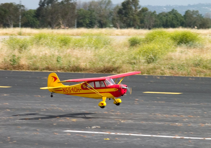

Also, the points must be set very close on these KALT 22's. I think the point setting is .010, Ralph do you remember? I have three of these that I've been running for many years. Likes to turn an APC around 8500 at sea level. I had Ralph convert one to his EI, just for ease of starting, a good move. This Aeronca is 13lbs, 86" wing, a good flyer on that engine.

ORIGINAL: Antique
That's a "purdy" Champ.[sm=thumbs_up.gif]
