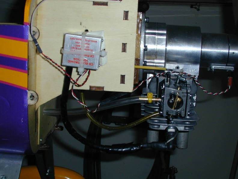

It's easy to solder in a brass tube:
Scuff the metal carb plate with a dremel sanding drum.
Scuff it right over the hole. About 1/4" around the hole.
Scuff a piece of 1/8" brass tubing.
Get out the silver solder and the flux.
Flux the brass tube and the metal plate.
Stick the brass tube in the hole.
Put the heat right in the middle of the metal cover plate.
Put your solder on the brass tube.
It will flow right into the hole when it's hot enough.
Let it cool and grind off any brass tubing on the inside to keep it from rubbing/puncturing the rubber diaphram.
Drill a 1/4" hole in the fuse former. Run a piece of cheap silicone glow fuel tubing from the brass tube into the fuse. Secure it. Leave it open on the end.
Go fly it.

Here's a pic of how I did it on my 4.2
The tube runs into the fuse.
Larry
