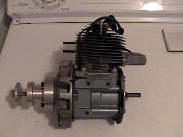

Here are some pics of an engine I won on e-bay. The seller believes it is a Homelite. Was told it spun a 24x10 on the bench. I have a A&M Sachs 4.2 and it is bigger that a 4.2. Can anybody help me out ? Thanks.
*rcnats*

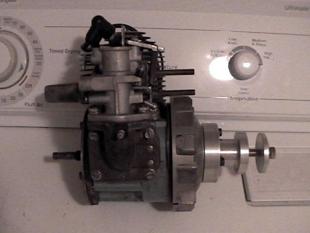

Default Here's another view
Check out this carb!
*rcnats*

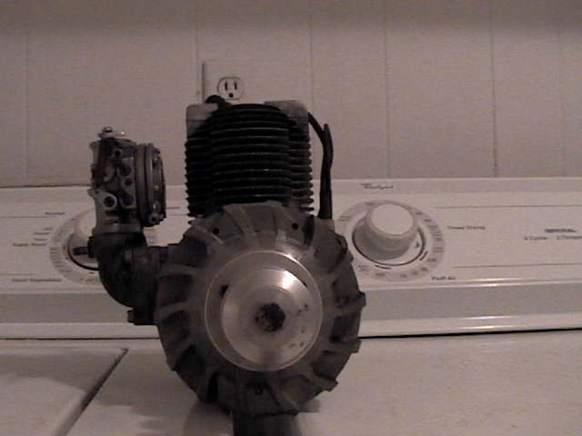

Default One more look
Another angle (from the rear)
*rcnats*

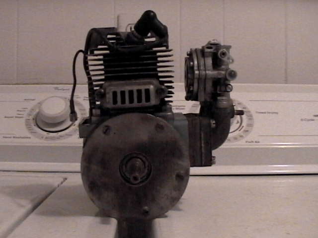

Default Final pic
Weighs about 5 lbs. Any info will be appreciated. Thanks.

I might say its large, about 80-100cc? maybe a MAC? thats only because I was rummagine at a small engine repair shop yesterday and the shape looked familiar, I like the angled carb mount, just what I need on my ProMac 60cc.

Very old McCulloch or Homelite with the Tillotson HL carb on it. In the 60s sometime. Muffler leans toward Mac.They weren't worried about ear damage back then!!

Make ? nope, never saw one like it..
If it weighs only 5 lbs now it would be about 4 lbs without the flywheel and coil..Very good for a larger than 4.2 engine..The bolt pattern of the carb is wider than the later Walbro SDC and WG series used on the newer engines..Easy to make an adapter plate for a different carb...It might be a little narrower with the carb mounted right on the case instead of the angle mount....
Looks like an interesting project

rcnats:
From the 1960s. Both Mac and Homelite had 6cu. in. or 100 cc motors back then. More popular HR carb kit will fit it. check saw shops. Same kind of parts in a Walbro, just rearanged parts a bit. As rcign says, may be easier to make a plate. Don't forget to put a pulse hole in it, if it has one on the intake flange.
