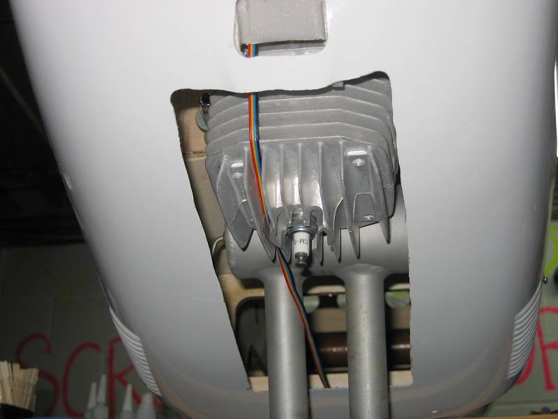

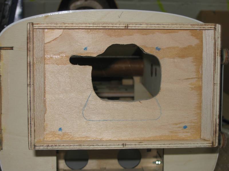

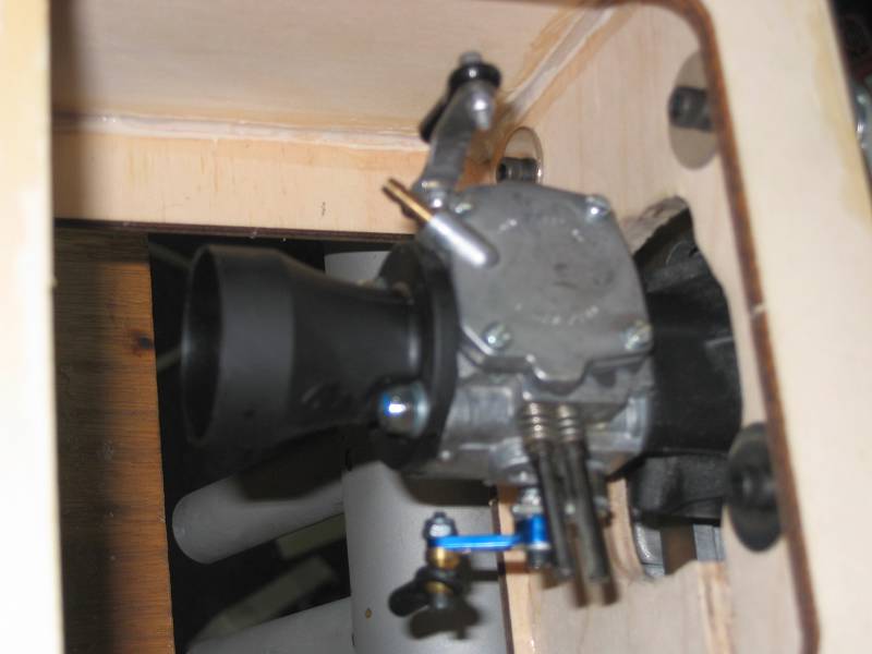

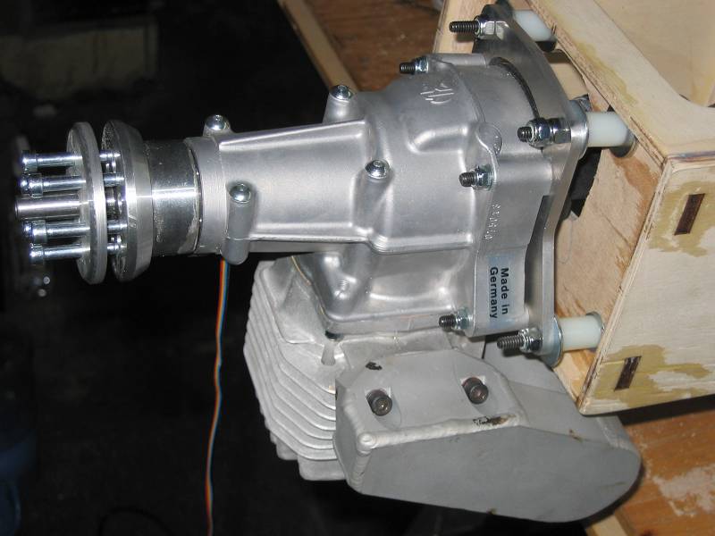

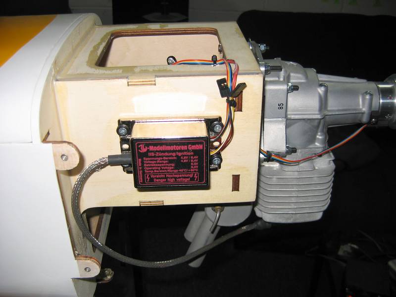

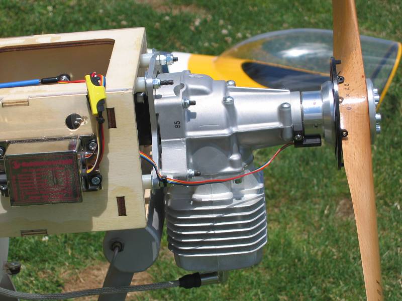

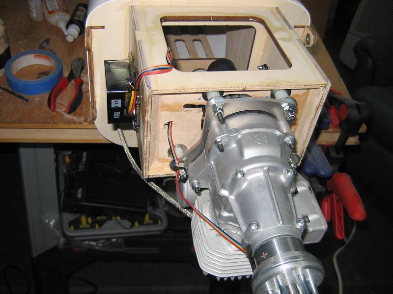

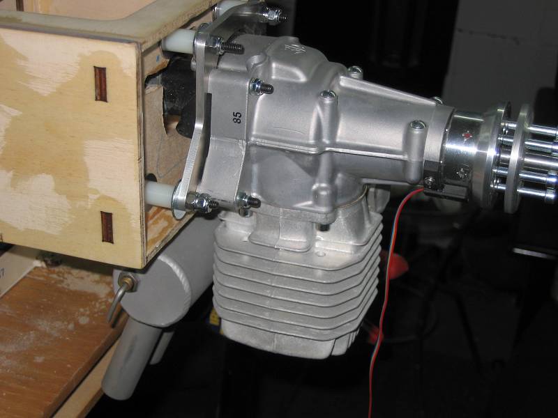

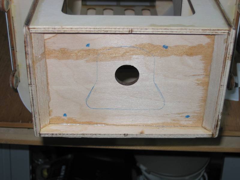

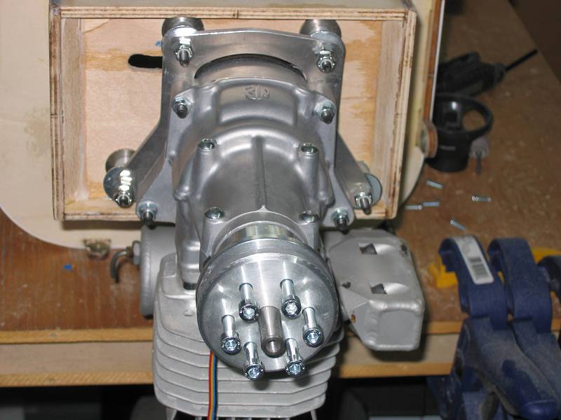

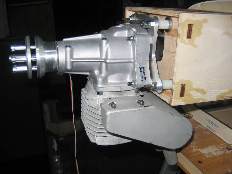

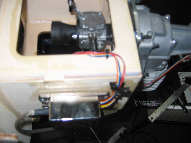

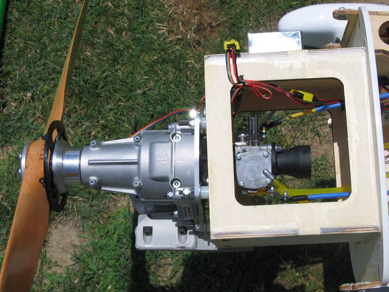

OK well it's officially mounted after getting some longer bolts today while driving around for work.
I am missing one pic for some reason... the first one outlines where I thought I would start to get an idea before I started cutting a big hole.
After the hole was cut and a space made so the needles could slide through the actual location was more to the right. So far so good.. doing landing gear, starting radio install tonight and have to do the canopy.
Weather check looks to be 10-15 on Sat and Sunday with sun.. looks like we are well on target to fire her up Sat. morning.

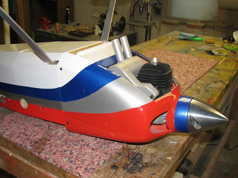

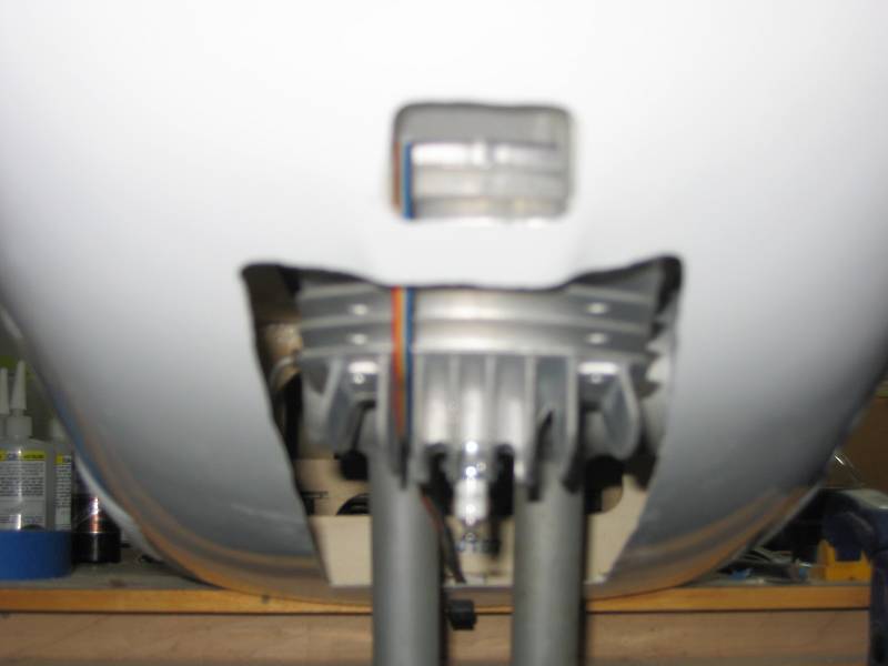

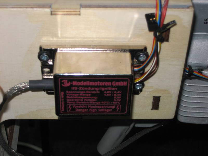

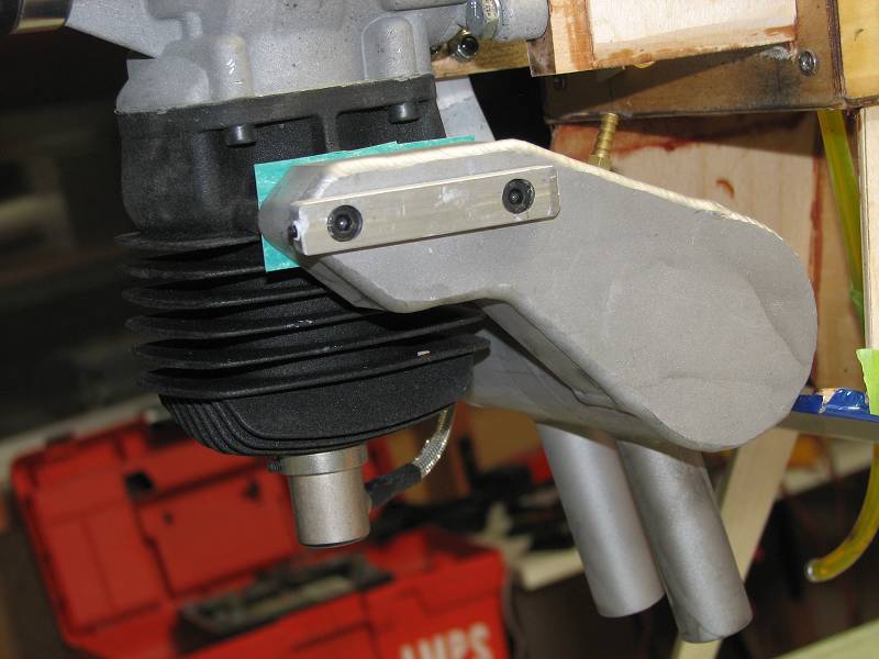

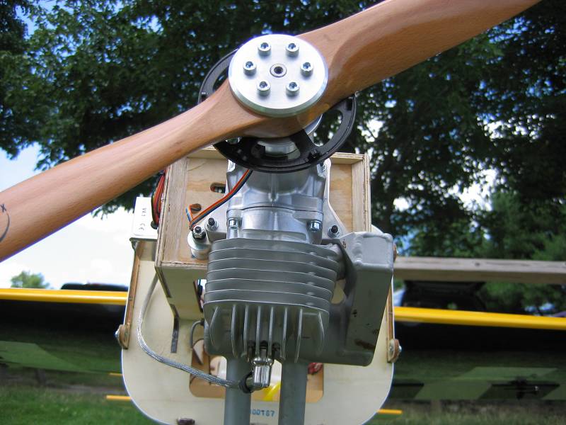

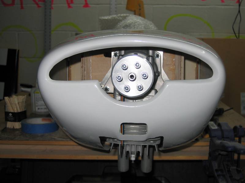

The cowl is roughly finished.. cut outs are still a bit rough but I will be trimming them off with fiberfinish from Maubid.
You will notice in the front middle there is a square opening.. I decided I would build a 6mm depron square with no bottom that directs the air directly over the center of the head.
I needed a fairly long exit since I am using a pitts muffler.. I am thinking airflow should be good the way it sits. Still pondering that one.

getting a good airflow around thru rear of fins next to the can really bugged me - that's why I did that tunnel which makes air path under the can then out thru that lipped thing at bottom edge of aft lip of cowl. In checking out burned up engines years back -the rear of the bore adjacent the muffler can is a "hot spot".
If my new eyes are right , your muffler can is smaller volume than the one I use - N/Y? again, just a comment -

I think my little ram air intake should keep her cool with all that opening in the bottom. This muffler is pretty close to the same size.. maybe a bit smaller.

Your cut out on the cowl around the cylinder looks good for air flow, however, I'm wondering why more people with singles in 260's don't block off the portion of the cowl around the prop and spinner. It would seem that a lot of the air would enter this area and pass over and around the motor. The reason I ask is that I'm getting a new Extra 260 and 85cc motor and want to make certain I've got max airflow past the cylinder for good cooling.
Can anyone say if blocking off around the spinner would be necessary or a good idea for cooling purposes in a 260 with a single.

As far as blocking off the top.. I will be getting some temp numbers so I will have more answers on that soon

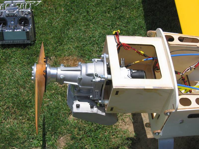

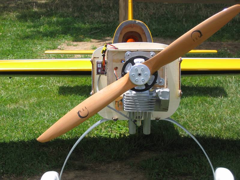

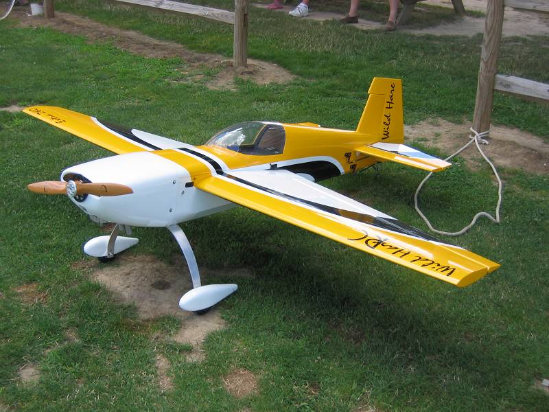

Well she finally flew today... I got 4 flights on her and then came across a rudder linkage issue which grounded me. Flights were short and sweet ranging from 10-12 mins with the first one being about 8 while I worked off the first flight gitters and got the madian out of the way
Intial impressions I was a little bummed about the top end numbers. Transition was extremely good and you can tell she is full of torque but the intial number was 5600 peak on the Xoar 27x10. Clearly a bit too much prop for it. However I didn't have a 26x10 to try so I thought I was just fly her and see how it did.
The plane came in at 24.28 pounds without my ignition battery in it.. 3W wants a 6v pack in there and I didnt have one with me at my buddies place to add with the scale.
Anyhow.. the field was packed and a bit windy so I figured I would put some flights on the plane and get it dialed in a bit while I got used to how it flew.
On the 2nd flight I noticed an audiable increase in pitch at full throttle... it appeared the engine was already starting to wake up. I was running Lawnboy 32:1 with 93 oct. gas (3W calls for high octane). For the 3rd flight I had to tweak the needles because the low-end was noticeably rich. As I retweked the motor and tach'd it my ears were correct.. she was peaking at 6050 and I backed it down to fly it at around 5880.
It def. has a nice smooth idle / transition and hauls around the 260 with authority. Hovering has plenty of pullout and verticle lines are effortless it def. doesnt loose any speed and a couple of times I let her climb exremely high.
Unfortunately no video today.. I wanted to get the plane dialed in a bit better. I had planned to film the 5th flight until I noticed my rudder linkage had a bunch of play in it. I had noticed trying a KE loop that I had lost all my rudder power and found the problem.
Needless to say overall the engine is doing quite well.. I will have a 26x10 asap. The guy who does video for me is meeting me Wed so I wll get some then for sure.
