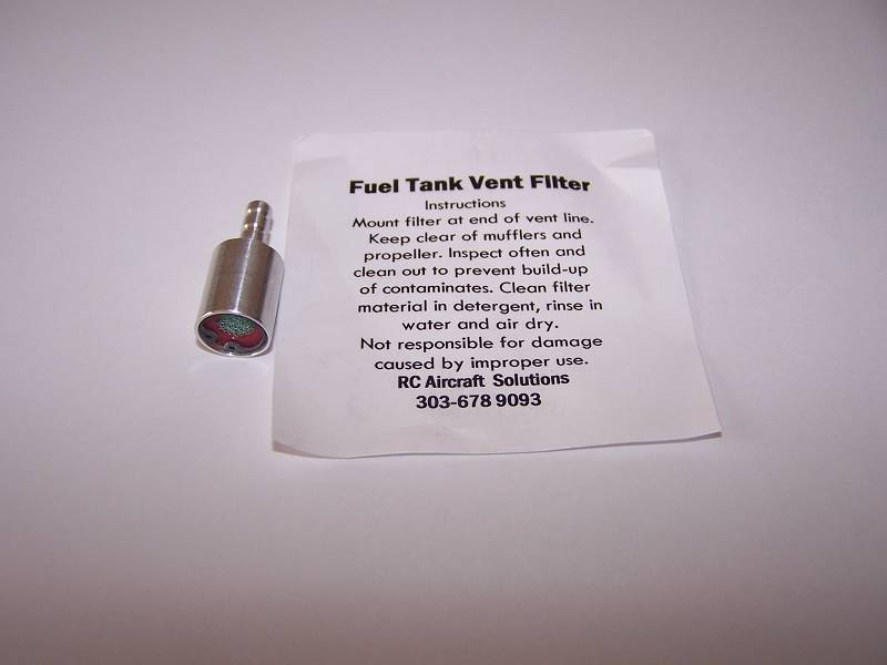

So will a sintered bronze clunk without the worries of having to "massage" the clunk or fear of fibers---There are also other types of clunks that filter without causing fibers to sluff off--I believe that Don's Hobby Shop sells a porous nylon? membrane clunk that works well...Also---Have you guys thought about the vent line for a filter??? There is suction on this line when the engine is running and this line will suck up debris from the ground that the prop stirs up..Have a look...I got mine at Don's Hobby Shop for $9.95--
Kevin

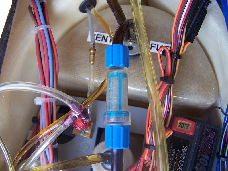

Here is a shot of a 4mm Festo filter in my jet which is fed by Tygon..Tygon turns dark with the jet fuel and oil in the fuel combo...My fuel in my jets is filtered a total of SIX times before the injector needles see any fuel...The injectors are the size of hyperdermic needles are can't stand to be clogged....My gassers get fuel that is filtered four times before the needle and seat see fuel...The last filter being the screen in the carb..
Kevin
