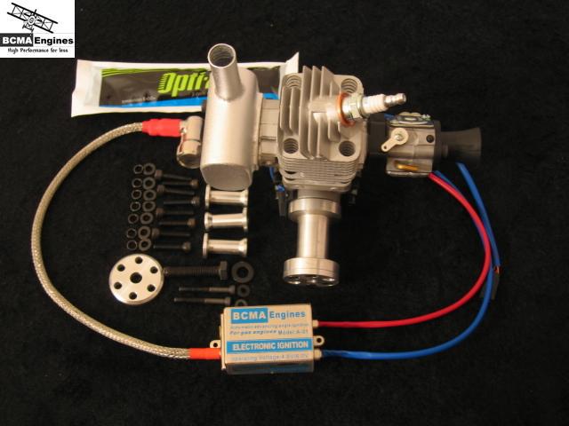

I need some help on a way to make some linkage for an SPE26 with a Walbro carb. Any ideas will help. Pictures...Thanks mxerman

From looking at the photo of an SPE 26 it looks like no special linkage is required. Simply attach a ball link, the Dubro kind with a white 2x56 snap on nylon socket. Then install a Sullivan Precision Rod (P/N 581) through the firewall. I use this type of carbon fiber reinforced rod because it doesn't change length with temperature changes.

Mine does not have that linkage. This is whats on mine..

It's very difficult for me to visualize, from the quality of the photos, exactly what you have. That being said, you can get a small piece of 1/16" aluminum and cut out a shape that can be screwed down to the existing arm. The ball link can be attached to this aluminum. You can use JB Weld between the aluminum and the original arm.
Many times I have had the same problem that you have and have had to think it through.
You might want to contact BCMA and ask them how they suggest connecting to the throttle.

Thank you bigbird!! I figured it out. A small throttle cable seems to be the answer. Thanks again, mxerman
