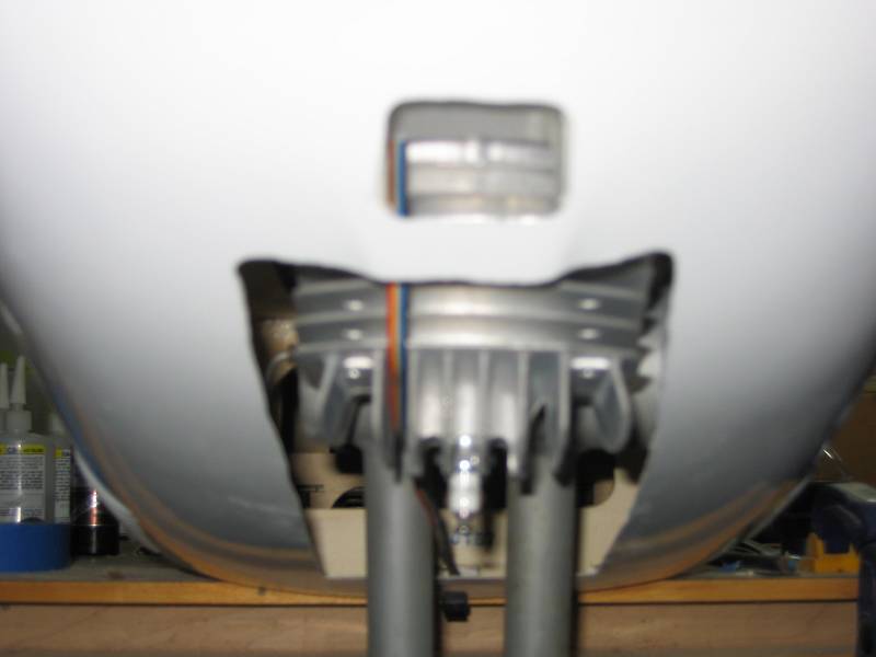

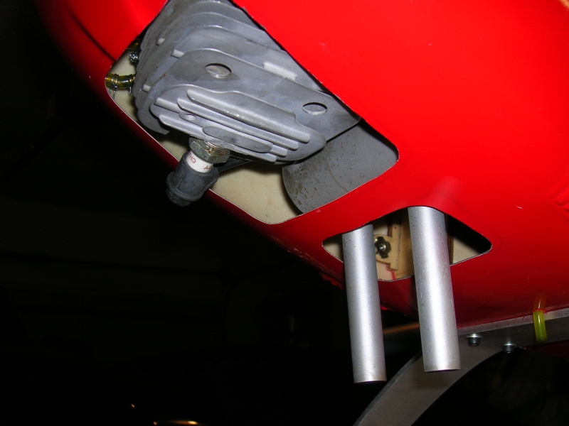

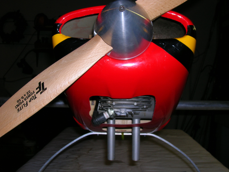

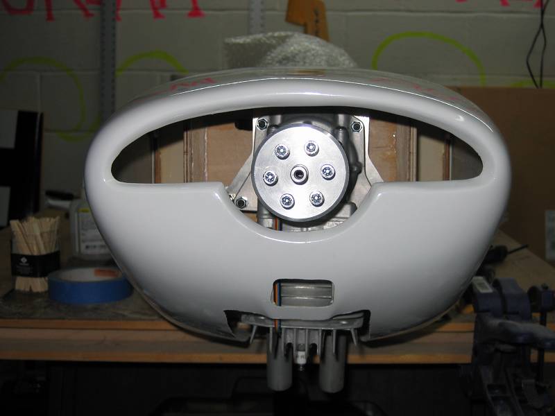

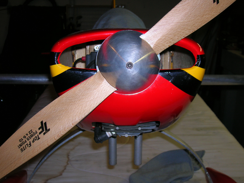

Man do you think I can find one pic of my Cap from the front? See where the cowl has a sqaure part that comes ut right in the middle of the head? Iwould cut that up higher and show more of the head. On my 3w85 I actually used some depron and made a square that directs air right over the middle of the fins.
The voltage checker you are referring to only puts 250ma or 500ma load on your battery... if you have a field charger set it up for a 1amp discharge and wait 5 mins to see if the voltage drops quickly.
Looks to me like you have not enough of head getting fresh air and not enough room for it to escape.
Here are some pics as I was in the process... after it was done I used fiber finish from Maubid (where is he anyhow) to clean it up

OK good spinner pictures...
The openings around the spinner do almost NO cooling, but they add to the air flow that must go out the outlet.
So block off most of this area. A 3/4" circle on each side is enough, and more opening in front of the engine.
I think your a bit low on exit air. Put a lip on that hole in the back where the exhaust tubes exit. Maybe this will create a vacuum and pull more air through?

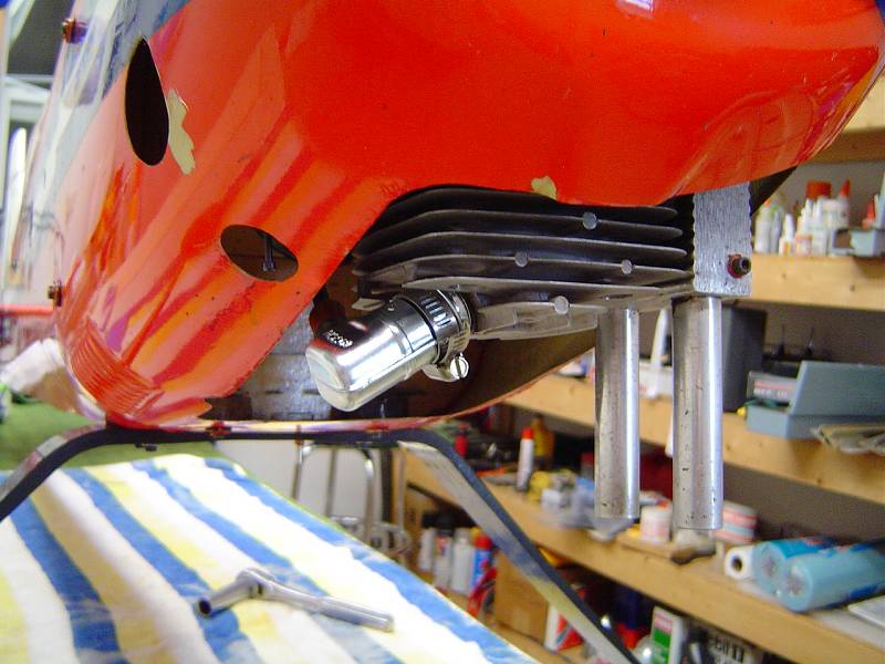

Here's a pic of mine with one of Ralph's G62's in it. No over heating problems at all, but I do have a bit more opening in the bottom than you. I used to have a DA50 in it with a pitts muffler, so the bottom is all open where the muffler used to be.
It looks like your G62 is one of Ralphs. If so, you need to check the neoprene hose that Ralph used for the pulse line going to carb. Mine was only a year old or so and looking at it, it appeared ok. Take it off and stretch it and it was full of cracks. A buddy of mine was the same way. This could very well be your problem.....
