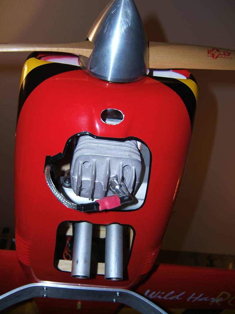

The below pics are of a DA in a WH Extra. I have experience overheating thus having the motor quit several times. The motor is currently at the factory being serviced.
I'm going to expose more of the cylinder and make a baffle/dam just in front of the exhaust tubes.
Can anyone give their estimate by looking at the pics as to whether on not the present cowl cut outs were suffcient to provide adequit cooling?
I also plan on blocking off inlet areas around the propeller. Is their any reason I should not do this?
Any other areas of this cowl I should modify?

It appears that the firewall is solid behind the engine with only a little clear space behind the top of the head. This could be restricting a lot of air flow. Aluminum or hardwood dowel standoffs would work a lot better by providing far more uninterrupted air flow. I know it would be a lot of work to change out but would be better than ruining an engine.
I think that the outlet area is OK providing you have minimally obstructed air flow. Of course an air diverter tab at the front of the outlet will help.

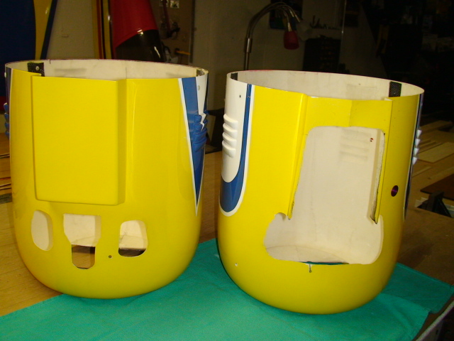

The baffles cannot work all by themselves. They need to make contact with the cowl around them. Foam, cardboard, anything that will close the gaps. In the picture below I made a cardboard system with baffle and short jacket inside a round cowl, which can be seen through the somewhat transparent cowl.
![](http://www.prme.nl/forum/images/makebaffle.jpg)
In front of the baffling system the cylinders are cooled by the air turbulation of the prop. Behind the baffling system the hot air is drawn out through the slit between cowl and fuselage, which probably is quite efective. Louvres like in a suchoi will provide excellent air extraction as well.

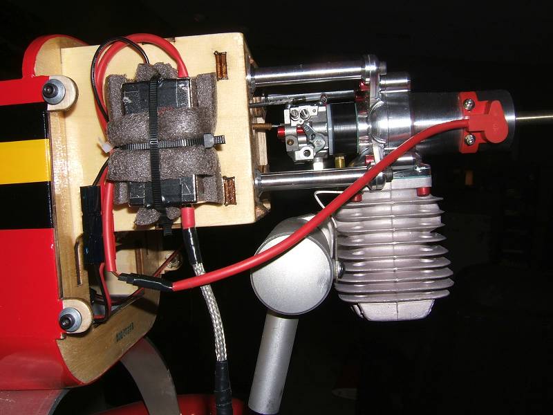

The engine is mounted by 3 inch aluminum standoffs. The below pic references the engine inside the cowl. Does this help provide for better explanation of poor cooling?
Again - what do you think about blocking the air intakes on both sides of the spinner? It would appear that much of the airflow is entering here and going over the engine with little reaching the fins?

Jaketab, that big hole above the engine is doing little for the cooling. The air that comes in there is only serving to crowd out some of the cooling air going over the fins of the engine. Close up the big hole. Paint the dam flat black for looks. Pe's baffle would be very effective but more work. It is the same idea that I offered with the article on RC Showcase earlier in this thread.

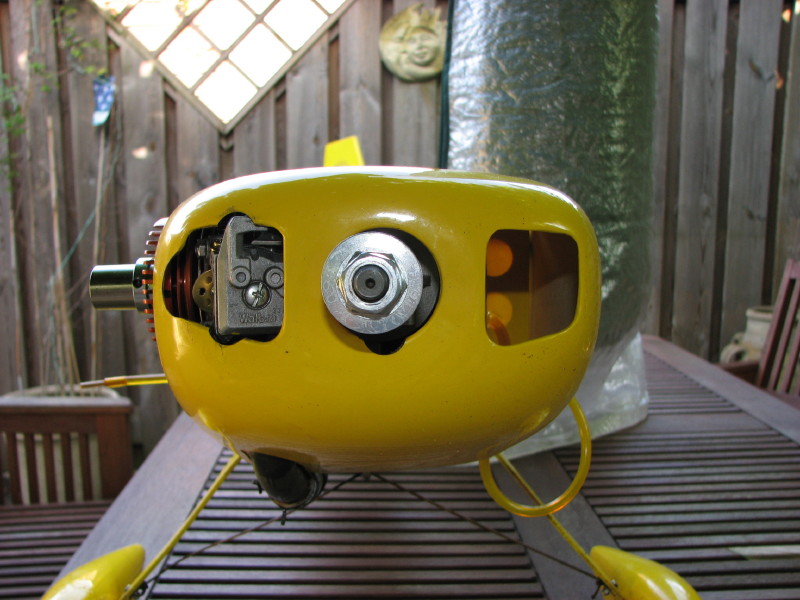

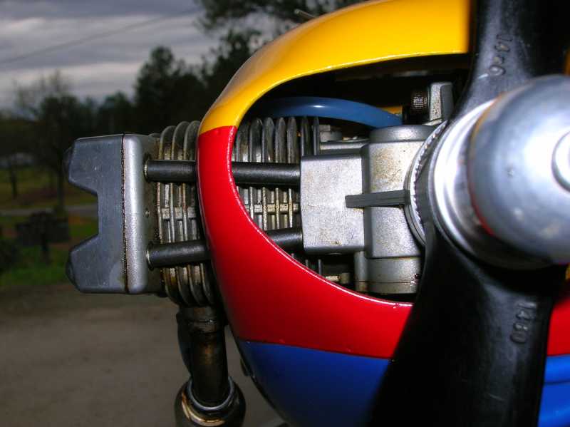

I received an engine for evaluation, together with plane pictures. These show the desastrous effect of the standard cooling rule.
Oil Castrol TTS, it helped to let the piston survive this ordeal save for a few light scratches
Spark plug dark brown, proof of excellent carb tuning.
Piston top carbon is ash gray, piston inner side black, just short of "death ash"
The cylinder max temperature was gray, corresponding too 400°C!! Needless to say, this engine did not make it past the 2 gallon mark.
Interesting to see is the bleaching of the anodize of the head. This is caused by heat above 180°C, before the steel will start to turn yellow at about 200°C

Pe, that looks like like a blatant example of how NOT to cool an engine. Probably most of the air was going through that big open hole and out the bottom of the cowl. The big hole should have been closed. The bottom of the cowl should have been opened up a lot more and rectangular in shape so that a turned down baffle (lip) could have been installed. The carb sure does take up a lot of space. It almost looks like that engine was too big for the cowl.
I realize that the guy was more interested in aesthetics than cooling. Sure is tough on an engine. The colors on the sleeve sure tell the tale.

That is why I posted this example. Most fliers are convinced that this is enough, while clearly it is not.
I realy am on a crusade to promote real baffling setups for ALL gas engines, and I hope this helps.

The attached images are of a Thunder Tiger 91 four-stroke on a SIG 4*60 that I finally got around to putting the fiberglas cowl on. It is a tight fit around the cylinder, and similar to the cowl setup shown in Pe's post, but not exactly like _that_. I've blocked off the top, bottom and left (opposite side) exit openings on the rear of the cowl. I have left as much of an outlet opening behind the cylinder as I could, but it isn't "three times the area of the inlet". Since I have the upper' lower and opposite outlets blocked, I don't have baffles on the left inlet or along the centerline; they can't be installed, the fit of the cowl is tight, and I need the extra room to wiggle the cowl on.
I _think_ that there will be good airflow into, around and out, but I've not flown it yet with the cowl in place, so I have no idea. I don't expect (hopefully) a problem, but the first flight I'll fly a very few minutes, bring it in and measure cylinder temps.
Feedback appreciated...
--Bill
I would rather call it vacuum cooling, because the air is drawn through the fins by the low pressure begind it.
--Bill

You won't hav a problem here. Air extraction is excellent and it is a methanol engine. They run much cooler due to the substantial internal cooling by the fuel.

Great, I didn't think I'd run into a problem. The plane is 10 years old and I've been planning to install this cowl for 7 years. I'm in the process of putting baffles around a Brison Twin engine and have been reading everything available on baffles and I got last minute jitters on this old project.
I used to work with aircooled Volkswagen engines, and being familiar with VW's sheet metal shrouds and baffles is helpful in designing the baffles on the current project. I'll post what I've done when I finish it.
--Bill
--Bill

OK, so that's a pretty good covering of cowled gasoline engines. What about a gasoline engine in a non-cowled installation?
I humbly submit my new Byron Originals Pipe Dream. In test running (hasn't flown yet), the engine temps seamed reasonable to me (no thermo here). Is it necessary to add an air scoop around the cylinder on this G38? It wouldn't be difficult with a bit of aluminum flashing and a few fasteners, but is it necessary?
Thanks!
J
Thanks!
J

Pete
In post #10 you talk about the type of baffling that is horizontal.
Can you explain that a little more, and how would one know if it's needed?
I picked up a used Yak, and cowl is kind of cut up.
Attached is a picture of my cowl, and a used one.
Can I still effictively use the small lip on the bottom to create a low pressure area to get rid of the hot air?
Thanks for any ideas
Bob
Bob
