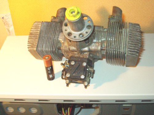

So, what is it???
Been told it's a Tartan 70 twin. I hae been offered this Engine. It turns OK and has good compression, as It rotates freely and commpression is very good and I can just turn it by hand (no prop) through TDC with some dificulty. It looks pretty dirty but that's all it is - DIRT! Oh, price 30 GB pounds ($48) !
Anyone know where I can get some info???
Many thanks . . . . .

Yep, that's the one. Useful looking beast and spec.
The guy who has it confirms it is the ST77. Looks interesting for what he is asking. I'll have another look.

that is a Super Tartan -and barring any damage - it can be made to run well -
there were ,any permutations of this basic engine - made by FOX in Italy-
with a custom reed bank and cleaned up ports and alky and oil - it made fair power -ad tuned exhausts and good power - BUT be ye informed ---unless someone will do all the labour for nothing - you can easily dump 200-300 into a proper conversion to get good performance-

Thanks for the info Dick. Emmm, may not happen . . . . the guy has started sorting through all His other gear in the garage, the sun is shining, he is getting re interested in R/C!!! He said something like "if I sell it". A week ago, He asked me if I was interested in it for 30 quid ( $48). I should have paid for it and taken it there and then! I'm not too worried, there's lots of other engines out there.

If I get the one up the road (picture on first of this thread), I'de probably also convert it to Gas. Emmm, think it would be earmarked for a BB (Big Bipe) also. What make is the Carb on these Engines?
OK- having been down this road - and having had the modified engines and having setem up with pipes etc-- here is my two bits worth -
they can be made to run - BUT just go buy a ZDZ60 - all in all cheaper and you will never get the power from the Tartan you get with a good 40-50 60 gas. also the 60 is very smooth - no problems on this 17 lb model.
this Tartan engine is about the weight of the 50 -60 class engines
We setup a TOC model in 90- with one of these - well modified -on pipes - it was flown to 2nd place by S Rojecki- I have one of the models - (I designed/ built them) still- but now with a ZDZ60 - and the power is much greater -
originally the Tartans turned about 9000 on 19x10 carfully shaped Max Daly props -
now I use a 24x10 MenzS or Mejzlic - rpms from 6000-7000 much beter recovery power .
