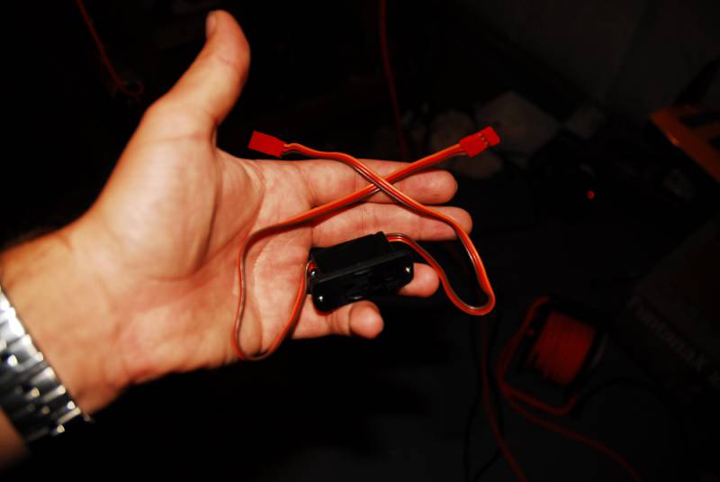

Good Evening Everyone...... I am new to the giant scale gas world, and I am currently in the process of building the Hangar-9 27% Extra 260. I have just installed the engine, but I am having trouble figureing out the how to attach the ignition to the battery switch that I have. The plugs do not match, so I was wondering what I needed to do to get them to work with one another. If anyone could shed some light on the issue I would greatly appreciate it.

You should have a 2 wire female plug (male prongs) coming from the Ignition and a 2 wire male plug (female prongs) coming from the battery. The other side of the ignition goes to the hall sensor. Post a picture of what you have...

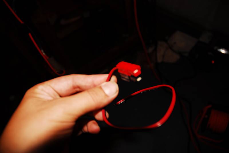

here are the pics

What kind of switch is it?
You may have to cut the plug off the switch to match the ignition. You can use these to get what you need.

I posted the pictures in the post above your last one...

PowerPole connector. http://www2.towerhobbies.com/cgi-bin...pole+connector

this may be a dumb question, but where and how do I connect those connectors?

You cut off the existing connector and solder on the one you want.

A standard heavy duty radio on/off switch works just fine. It helps if you obtain one of the nice DSC switches that has an external charge port for the battery. Simply cut off the Power Pole connector that came on the ignition end since they seem to often be a problem. Take a servo extension and cut it in half. Solder the end you need to mate with the switch on the ignition end where you removed the Power Pole connector. You'll have a wire from the engine that plugs directly into the ignition unit, and a wire from the ignition going to the switch. One wire from the switch goes to the battery.

The Power Pole connectors are really nice and can handle a lot of amps. I use them on my stuff. However, most people seem to leave the connector ends unsupported inside the plane and Power Poles don't like that. They can be shaken apart in that enviornment, causing an ignition cut. The easy way is with something that you already have versus what you have to go out and buy. Power Pole connectors are not standard hobby shop or small electrical store items.

You need one of this from Troy Built
http://troybuiltmodels.com/EngDesert...ignadapter.htm

great.... this adaptor is exactly what I am looking for........ Thanks everyone!!
