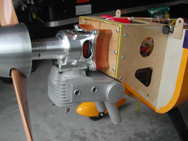

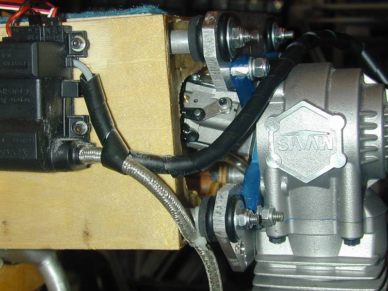

I did a similar thing on my QQ Yak the engine is solid mounted to the ali units and then flexably mounted to the firewall, it also gets over the horrible feeling that the bolt hole is too close to the clearance hole for the carb.

AW 75cc Extra 260 with DA 85. Shows the .970 ply spacer that comes with the plane. I shimmed mine an extra 1/8 inch.
I have not flown yet and can’t comment if any change of thrust is needed.
I can say this is a very impressive ARF construction wise.

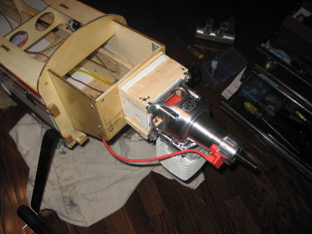

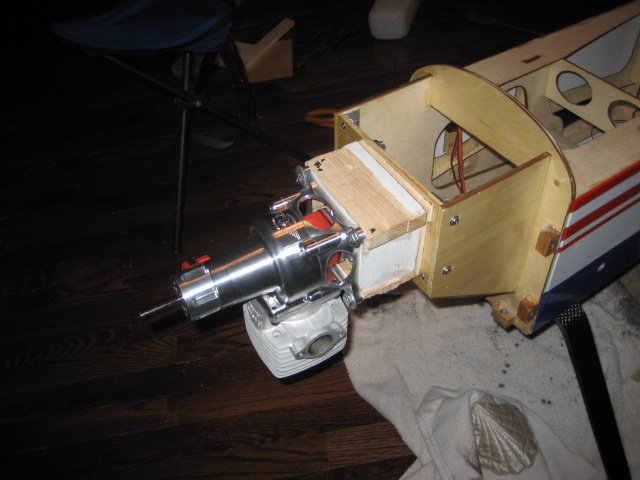

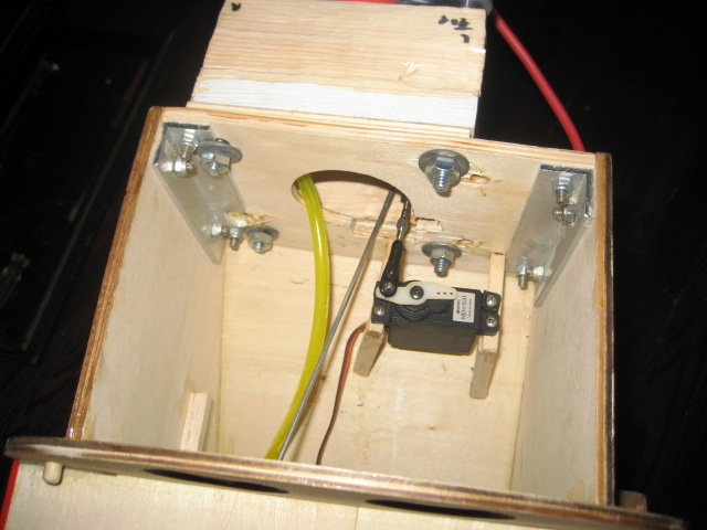

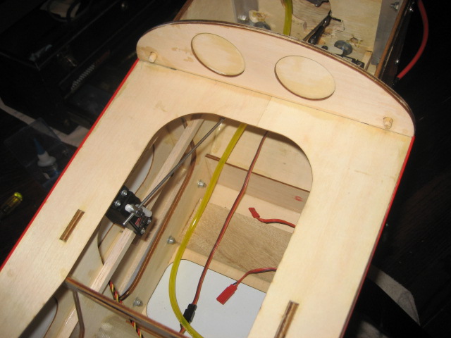

This is how I did it on a H-9 Cap i think i cut this week from scraps lying around the house to make this box, as I to saw were they Da did not seem to be pushing stand offs....
ID:	772104   Click image for larger version
ID:	772105   Click image for larger version
ID:	772106   Click image for larger version

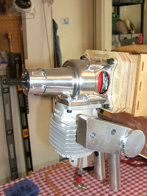

Here's a picture of the mount I made for my 85. The mounting plates are made from 3/4" maple cut on my scroll saw. The shape of the mount matches the plan view of the rear engine mount so it's light. I applied fiberglass resin on the inside and outside of the mount. The other side of the mount has a hole to get at the carb needles for adjustments.
Regards,
Steve

Great Job on the mount. Clean professional-sturdy. Only concern would be if you have to shim with a washer or two for thrust adjustments for fine tuning the plane.
The minute you pull the engine away from the hard mount with a washer or two it would then defeat the purpose of the hard mount, like a standoff would.
Perhaps if shimming (fine tuning) the aircraft, the best solution is to hard mount the engine to 1/4 or 3/8 aircraft plywood soaked in resin or CA to harden "fuel proof" the wood plate then mount to the exisiting firewall as far out on the corners as possible with precise cut 3/4 - 1" hardwood dowel material with 1/4" bolts, that way if shimming is needed you could just re-cut a slighlty longer dowel on the appropriate sides.
The wood dowels to wodd plate is more likely to absorb vibration over aluminum standoffs with less transfer to the airframe, plus the spread on a 1" dowel really helps.
Just a thought. I may give this a try first. Thanks for all the help. I'll post pic's once I get fabricated. Dan

No problem adjusting thrust in any direction. You just have to sand the wood block on a flat table. There's no need to use washers or shims. In fact, I accidently built in too much right thrust into the firewall when I replaced the original firewall. I had to remove a 1/2 degree out of the wood block.
