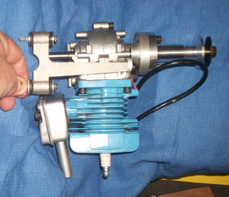

I just got one of these engines (BT32EI) today, to put in a 1/4 scale Super Decathlon. Nice looking engine, and have heard good stuff about them, but never owned one. Couple of questions though:
1-the Fuji, and Tower, literature list both the BT24 and BT 32 as having 2.2hp. Why wouldn't the 32 have more than the 24?
2- why is there a shaft out the back; what else can you hook up to this engine?
3-Do you think using DuBro antivibe mounts would work on this engine, as shown in the picture below? There's a mount a little larger than the one I'm holding, made for larger engines. This mount would allow the muffler to clear the firewall without having to make a box (the rear shaft would also clear)
What size prop are you using and what's your performance like? I plan on a 18-6 for the Super D.

Thanks for the info on how to get to the Fuji forum. I'm no expert, but I would guess that the shaft out the back of the engine had a use in the engine's previous life in a leaf blower or whatever. I suppose one could mount a spring starter on it, but my 32EI starts with one flip after priming so why bother. The plane I put the engine on, a Giant Supersportster, has a hole in the firewall to clear the shaft; the muffler clears the firewall with the mount that comes with the engine, but just barely. I cut the shaft off anyway because i was going to mount the EI module on the firewall behind the engine. I ended up putting the module behind the firewall, so all I really accomplished was reducing the engine weight a little and most likely voiding the warranty.
As for the flex mount, Fuji recommends using a flex mount when then engine is on a test stand or other rigid mount because "The crankcase and other parts of the engine may crack if you do not provide some kind of vibration absorption mechanism". They say it is not necessary if the engine is mounted on an airplane, but I have seen posts on the engine forum about Fuji 32 engine castings breaking so I would say that a flex mount might be a good idea. Whether mounting it to the lugs on the front of the engine as you have shown is a good idea for not is a different question - I have no idea.
I am using an APC 18-8W (wide blade) which I ordered by mistake thinking I was ordering an 18-8 (regular blade). It works fine, turning about 7200 slightly rich with one gallon through the engine. According the review in the Nov '06 RC Report by Dick Pettit, he got max RPM of 7950 with an APC 18-6W, and 7740 with and 18-8. These are max readings, so I presume that you would run a little on the rich side of these speeds.
