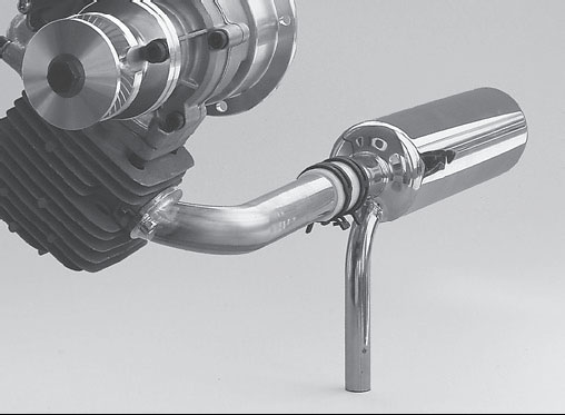

Spacing is 42.5mm at manifold on Zenoah 62 and 40mm on DL/DA. I just bought this tuned pipe/silencer and havn't tried it yet. But, it LOOKS quiet and is supposed to add 25% power
There is room to trim 1mm out of each mounting hole on this S/S header.
The price? Well about the same [

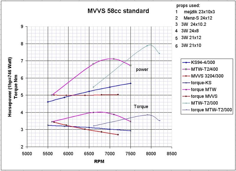

My Latest test data on the 58, using two tuned pipe header lengths on the MTW tuned pipe (the one for DA), MTW TD75 canister, KS canister, and the MVVS canister setup.
The 400mm long header sets up the tuned pipe engine in the sweet spot, the short 300mm header makes for a more finicky engine. Loads of power, but only with the right setup.
Edit:
I hope the picture explains all.
The MTW tuned pipe on the shorter 300mm header shows that the typical torque hump at 3/4 of best torque rpm enters the operating window of our props (5500 - 6500 rpm) A slightly shorter header might be even called for to take advantage of this.
Edit:

You got three pipes x two header leinghs x testing for two things (torque & HP) = To me there should be 12 lines on your graph but I see 8.
How about a quick written conclusion?
I think for my DA50 its "buy the DA pipe, use a longer header"
Pipes-- (sigh)
if you want plug n play results - -you came to the wrong place .
reading charts is easy for guys who use charts all the time but for others - a complete mystery -
notice that the best torque happens at different rpms .
Also the torque curves and horsepower curves are not the same
now what?
well -you can't just keep changing pipes and header lengths and going up all the time
there is an absolute "totally maxed out" point - but the charts really don't state that.
basically - the best -smooth running setup (nice even midrange ) -is your goal
To do that - you will NEVER get peak power- but you will get a few hundred rpm increase on typical props for that engine (which is a LOT of power increase)
be ready and accept that your combo must go thru some mix n match of props and header lengths -if you want best results.
now what?

ORIGINAL: dick Hanson
[sm=cry_smile.gif]
I know, I'm gonna have to do some of the work.[&o]
But I'm sure there are conclusions about the different pipes that can be make at this point.

Thank you for carrying out these tests and providing these graphs. They make some interesting reading.
The MVVS 3204 canister displays a remarkable flat power curve, smack on 5 Hp throughout from 5600-7400 rpm. Never seen anything like it.
I get 6240 rpm with a 24x10 MenzS on the 58 Prosport, which according to your prop/power calculator translates to 5,70 Hp. This is with the MVVS 3204 Can. I also get very similar revs. with the same propeller and a MTW-TD110K. Interestingly, this is exactly the revs where the power curves for the two different cans cross each other. (Although you tested the TD-75K)
Comparing this to the MTW-T2 at 400mm header length, you are showing a whopping power increase of more than 40% (@7000 rpm).
Dick Hanson stated above:
During your tests, did you get a feel for how the midrange, and general "throttleability" is for the engine with the T2 pipe @ 7000 rpm?
Also, you have a measurement at 7100 rpm, which propeller was this with?
Kind regards,
Magne
