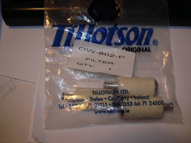

ORIGINAL: OldRookie
Do you have a model or part #?
Greg
Over here the Tillotson felts are popular, they have no clamp.

Thanks guys for posting the pictures, that helps a lot.
