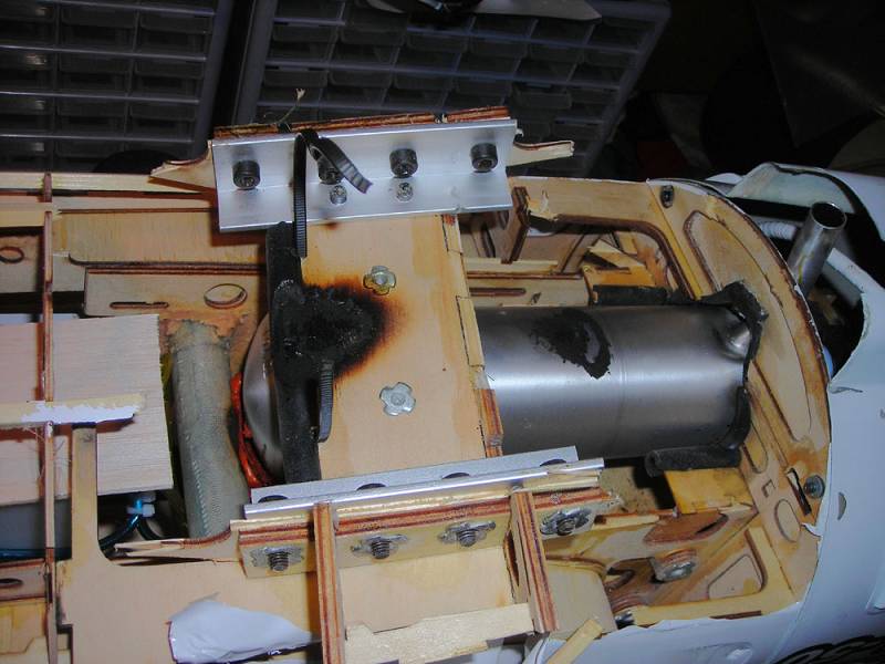

The LHS wanted $9 for a foot of silicone tubing, so I bought 7 feet of neoprene vacuum tubing at Auto Zone for $3.47 and used that. I've got about two to three hours on my canister setup. I see no adverse affects from the heat. I one of my can setups the can was hot enough to char the wood, the neoprene was still ok, you could see it was getting hot though. I'll see if I can find a picture of that.
The one with the burn was fully enclosed, (landing gear tore out), the red one that is showing no signs of heat is semi enclosed.

Neoprene will absolutely break down with heat. You just haven't been running it long enough to see it yet. The silicone also better isolates the wood from the cannister heat. Try checking out a boat shop where they service inboards. You'll likely find silicone tubing products there.
