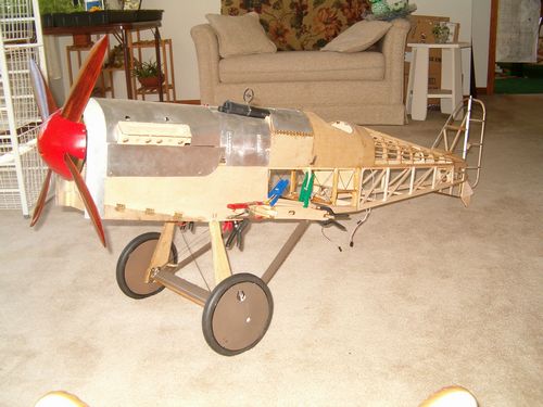

Please let us know how it runs. I have one also waiting to be run. I think the muffler and single exhaust pipe could be better. What prop are you starting with?

That sounds right. I am hoping to turn this 20x8 four blade prop after the engine is broken in.
