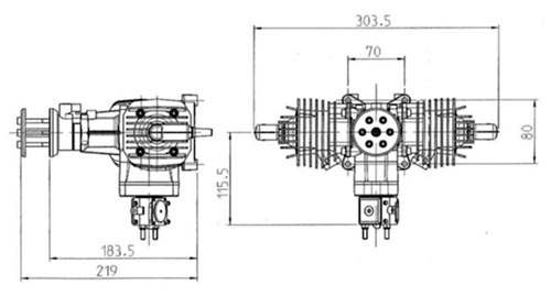

What are the measurments for the DA-100's bolt pattern to mount it to the firewall?
I have tried for two days to call DA, but they are so busy I can't get through.

Same as 3W's 100 bolt pattern 70mm wide by 80mm high.

Here you go>
