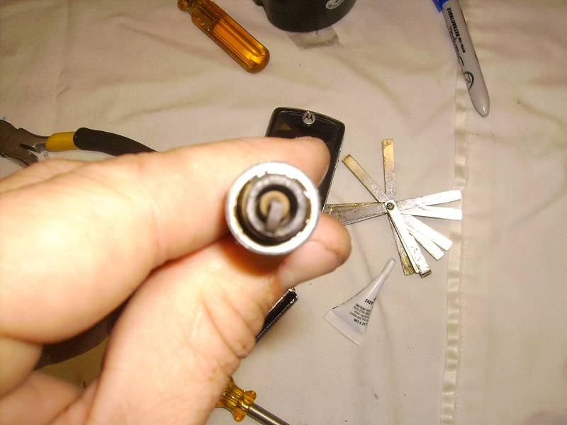

I have a DL50 that runs good but at full throttle it will "blip" a little from time to time. I took the best pic I could of plug to see if any of the gurus here could tell me if I still have some leaning room or about right.
Any suggestions much appreciated. I hope the pic shows enough.

I'm no guru nor a "spurt" but your plug looks good to me. I've seen/heard some high throtlle "blips" a few times and they always seemed to be voltage related. Make sure your ignition switch, extensions(adequate guage) and connectors are in good shape and haven't been exposed to extreme heat such as being too close to the muffler/cylinder and degrading (melting) the shielding. Check ignition battery voltage with a loaded voltmeter? Have you tried running the motor with battery plugged directly into the EI and by-passing the switch and extensions to see if the "blip" goes away? If you do by-pass the switch to test, make sure you have an alternative way to shut down the engine!

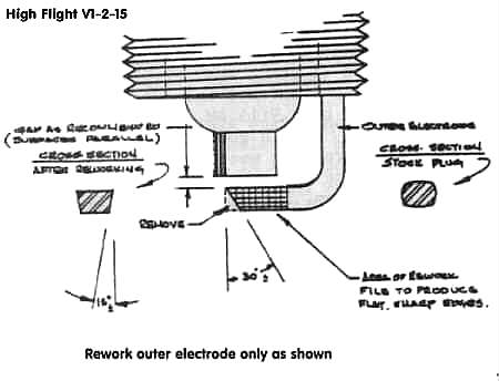

What is the gap set at? You may also try this in photo. Regards, Capt,n

I wouldn't touch the needles. That looks just fine.
If those little blips you are referring too are like quick, short "hiccups" in running it's possible that the engine is experiencing a little carbon ball fouling at the spark plug. The "blip" that happens is the plug mis-firing until the carbon ball at the gap is cleared. It's pretty common and if the oil ratios are reasonable there's not a lot you can do about it other than open the plug gap up more. That's not the best idea though.

Is far as I can judge the picture, the plug loos excellent, but there is no leaning room at full throttle. Your plug body rim is a bit too pale for me to feel comfortable. Try a slightly richer H-needle setting, but be sure to keep track of what you do.
This paleness I think is there can also be due to camera, lighting, type of gas and oil brand, so you may have to go back to your original setting in a hurry.
I would rather look down into the plug body and try to find the little black carbon deposit mixture ring where body meets isolator. If it is there, leave the needle setting alone. If it isn't, open up the main needle.

With your plug colour, blips surely are not due to rich settings, so leaning will not solve them.
Like Pat said, these blips may be caused by plug gap bridging of one kind or another. (lead whiskers or carbon) Lead fouling will not happen in leadfree fuel.
At idle, the idle needle is the only active control. The idle needle supplies about half the fuel that the H-needle does at full throttle, so closing the idle 1/4 turn means the H-needle must be opened about 1/8th turn to compensate.
That also is why the idle mixture must be set before the full throttle mixture, only to be touched again for fine tuning.

cap'n - this looks almost like those magical "special" electrode shape plugs that are supposed to be better than sliced bread. I'd be real interested in reading any quantitative data/information about what this reworking of electrodes is *known* to have done for an engine's performance.
I've seen things like this done before....the person installs the modified plug, then has to "readjust mixture". Well, the mixture was probably not right in the first place, and the person tweaked the gap through all the screwing around with the plug, and HAD to change things. So they lucked out, adjusted it "better", and decided that the rework of the electrode was the magic cure.
I'm not saying doing what your picture shows doesn't improve something - just wanting actual data to support the benefit of it.

The sharpening of the electrode provides a stable, hotter spark at a fixed location every time. Electric charges love sharp edges so they can ionize the surrounding gas and make a spark jump.
Whether this provides more power or not remains to be seen. It does however reduce the voltage needed for a spart, and make the spark more consistent. It also increases the available top end rev range, because less capacitor charge is needed (In CDI) or dwell in contact breaker ignitions. That is why pure racing plugs often have a very thin central electrode. For sustained spark energy at high rpm.

Hellow Bob: The photo in post # 3 has some data on source. High Flight V1-2-15 in upper left corner. I have done the mod only to mag engines that have kinda weak spark to begin with. Boy they start a lot better...and the idle speed was a tad higher without adjusting anything. For kicks I set the idle as low as it would run on mag. I had guys say they never seen that paticular engine idle that slow. I am positive it ran better in all respects. It is a lot of messing around to do. I want to warn guys that do this. Make sure no metal filings are left on plug. Glade to share with all...just like you like to share. Tis a good thing! Best Regards Capt,n

Pe and Cap'n - I am always open to new stuff, when known to be valid. This seems to be the case on squaring of the electrodes. I apologize if I sounded "doubting", but I tend to be cynical by default.

Pe ( and cap'n, if you're around) - I checked my NIB NGK CM6's and BPRMR6's, and they were nicely-squared, although not "sharp" cornered, but sharper than other brands I had. Interesting learning, here. Thanks!

The center post of some spark plugs have a spline look to them. That spline makes for edges...that can help the spark jump the gap! Capt,n
