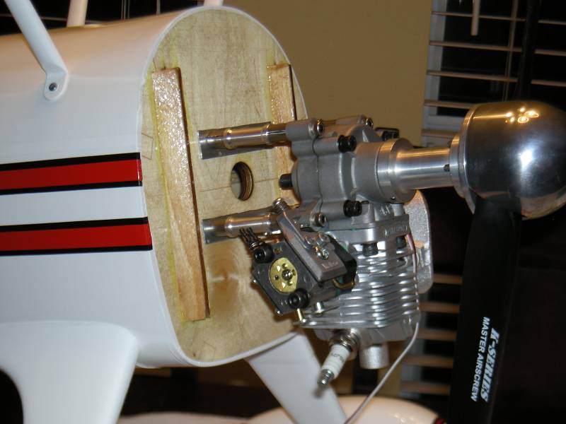

O.K. Here are the pictures of the mount. Please be critical. I can easily change this. It's my first attempt at a gas engine, but I am a pretty competent mechanic. If the wooden dowels are better, it's just a short trip to Lowe's.

Here's a few more of the mount

Although the installation appears rigidly mounted, in this case it's not. It's a bit worse than using long one piece standoffs since you have room at several places for the standoff to permit the bolt inside to move a little. Long single piece satndoffs are not a lot better since they permit twisting from engine torque to transfer through the fire wall.
If it was mine and I needed to use a long engine offset then I would use two 3/4" wide hardward blocks the correct length, drilled for the bolts, to attach the engine to the firewall and eliminate the twisting forces.

He means two pieces of hard wood. Cut to be slightly wider than the engine mounts, the same width as your currant standoffs are and from 3/4" solid wood. So a piece of oak or maple about 4"x2.5"x3/4 thick, times two.... A large lightening hole can be cut in the center. Glue the blocks on edge wise to the firewall. And drill it for the engine. This will give it latteral strength.
Another option is to use 3/4 or 7/8" dowels like the picture above but cut grooves for installing shear webs between each standoff to give latteral bracing. Glue the dowels to the firewall also.
The torque load of those standoffs you put together will go directly to the engine mounting lugs and most likely break them off in short order.

That would not happen immediately, but the firewall would start suffereing abuse the first time it ran. Using two wood blocks with cut outs to let the mounts clear the carb will last forever. Long metal standoffs will not. Depending on the firewall composition long standoffs can be very short lived.

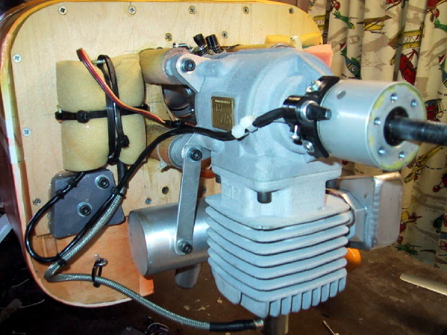

Here is a method that looks good to me to mount a engine! Regards, Capt,n

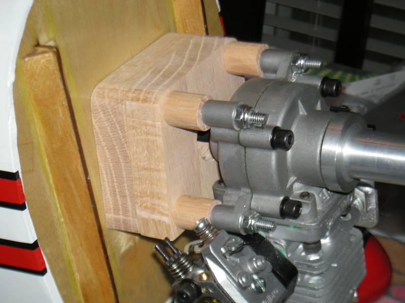

O.K. How about this? That's two 3/4 inch blocks with 5/8 inch dowels. All red oak. The bolt is all thread with nylon lock nuts.

That arrangement looks real neat and sturdy but maybe a bit on the heavy side for my liking. I would certaintly make good use of some serious lightning holes wherever possible.

The oak isn't going anywhere! Very sturdy indeed [sm=regular_smile.gif]
Allthread can be a bit soft. If you can find some caphead bolts the right length, they would be better.

The allthredad is 4" long. I couldn't find a bolt that long. How about stainless allthread? BTW, the plane needs the weight up front.

Try what you've got. The nuts can be nipped up after some running if necessary. The oak looks MUCH better than the stacked standoffs you had to start with [sm=thumbup.gif] Functional ballast weight is also a plus.

What I would like too see ...is more metal around the mounting lugs on engine to begin with. It is not going to add that much more weight! Capt,n

You can obtain 4" number 10 hex head cap screws for about a buck apiece from [link]http://www.microfasteners.com[/link] The all thread works just fine as well but you have to secure both ends instead of one. The nylon in ny-lock nuts gets hot when used on an engine and loosens up so you want to check them frequently. When you're completey satisfied with the engine installation and have no possibility of needing to remove it for a long time use some green Locktite on the nylocks to better secure them.

I will replace the allthread with stainless; the locknuts with nuts and lock washers and locktite. I will install engine without putting epoxy on the mount or drilling more lightning holes, put in all radio gear and see how she balances before drilling more holes.
