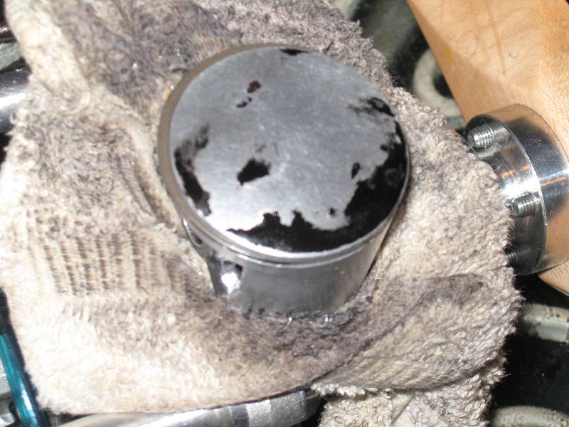

Is this normal?
After the 7th 32 ounce tank i decided to take my DL-50 apart and inspect, i noticed the top of the cylinder to have a hard layer of black crap, and the rest of the insides of the motor were clean i was using lawn boy ashless with mixed 32:1 for breaking it in

Yes - that carbon layer is quite normal - the first layer builds up pretty quick.
Why are you taking it apart so early? You are more likely to do more harm than good by doing that.

Probably normal for lawnboy oil. But not good for the engine.
Are you POSITIVE that you have it tuned and leaned out on the top end? Running excessively rich will cause carbon buildup.
I'd switch oil now. The popular thing to do is to switch to a synthetic now. I don't use synthetics and I don't have carbon problems. But it's up to you. It's your engine. I'd switch to a high quality oil and lean it out to 40:1 or 50:1. Then TUNE the needles again. Lean the high speed needle to max RPM. Use a tach if you have too. When you hit peak RPMs, richen it up about 200-300RPM and go fly it.
I'd also clean that carbon off the top of the piston before you move on. You already have it apart, might as well get rid of the carbon. I've never had carbon like that, so somebody else will have to tell you how to scrape it off. DO NOT use a steel brush!! I do know that to be true.

Yep - I wasn't going to get into that in my previoous post. I tend to run in on the likes of lawn boy for a gallon or so then switch. The carbon layer builds up like the photos show but never gets worse after that.
As RCPilet stated - make sure your engine is tuned well (like all engines should be).
thaks for the quick replies, i took it apart after reading so many posts about whats good and what isnt about oils, there is soo much controversy , i wanted to see first hand how the oil i am using is holding up
im not 100% positive i have it tuned for max performance, but i will work on it for sure tomorrow
any advice on how i can remove the carbon from my cylinder head? or will it not affect my performance

You can carefully use the sharp edge of an exacto blade to scrape the carbon off the piston dome. Don't be concerned about getting 100% of the discoloration and end up gouging the piston. Just go slow. What you see is absolutely normal for Lawnboy.
The cylinder is tougher and you need the right tools for the job. Do not use sharp edged tools for this location. The cylinder has a hard metal liner. The top of the cylinder is often soft alloy. You most certainly do not want to put grooves or divots in anything. Pe Reivers suggests a piece of broken glass and it makes sense in a way. Ball hones and soft brass conical brushes also do the trick.
Any way you go about it, before you do anything else stuff some clean cloths around the piston rod where it enters the case. That both protects the rod and keeps the crap out of the case. Whe you reassemble the engine apply a coat of whatever oil you will be running to the piston and cylinder. Not dripping but wet enough to lubricate for that first start up. Otherwise you will be starting a dry engine and that's not good at all.

thanks pat i took your advice, and used a razor blade a scotch scouring pad some gas and wd40 to get as much of the carbon off, ill turn her on tomorro hopefully it will run as good as before.

Carbon deposits on the piston crown are normal. In mineral oil they are quite hard, but with synthetic oil they are soft and do not tend to grow much.
The carbon should not extend to the piston ring lands, where it will lead to ring sticking. Once the rings stick, exhaust gas blow-by will cause pistons to seize because the heat flow from piston to cylinder is disrupted.
When racing, I found some carbon on the piston skirt useful when running a mineral (dynosoar)/castor oil blend, just enough to fill in any irregularities so the piston could ride on a full oil film. Modern "synthetics" will clean very well, and prevent these deposits.
