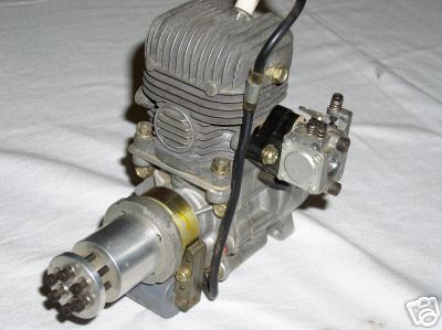

I recently purchased this engine and looking for any information on it.
Thanks for your help.
TJDNC
