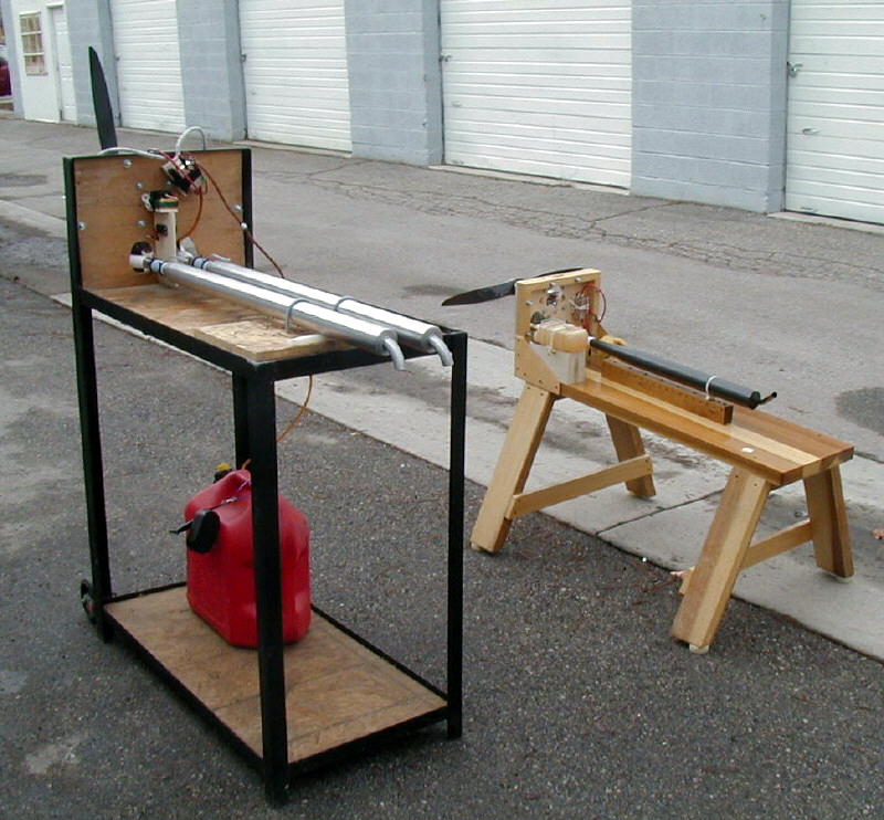

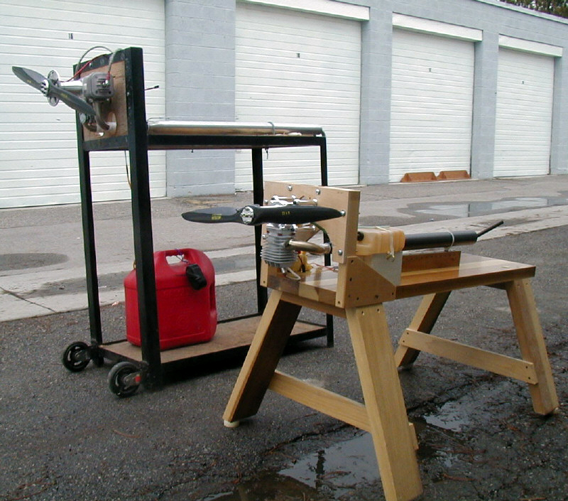

We did some pipe testing this week at ES composites shop. pictures added.

Main testing was on the DA 150 on greeves pipes.
mej. 32x10 open header 5600 rpm
9" to 11" header 5800 to 5900 rpm best transition 10.5" header at 5800 rpm...
mej. 28.5x12 three blade same same same....
DA 50 on ES pipe.... mej 23x10 10,000 rpm or something like that (just joking) 6800 i believe.... and deadly silent.
more importantly look at that beautiful test stand!!!!!

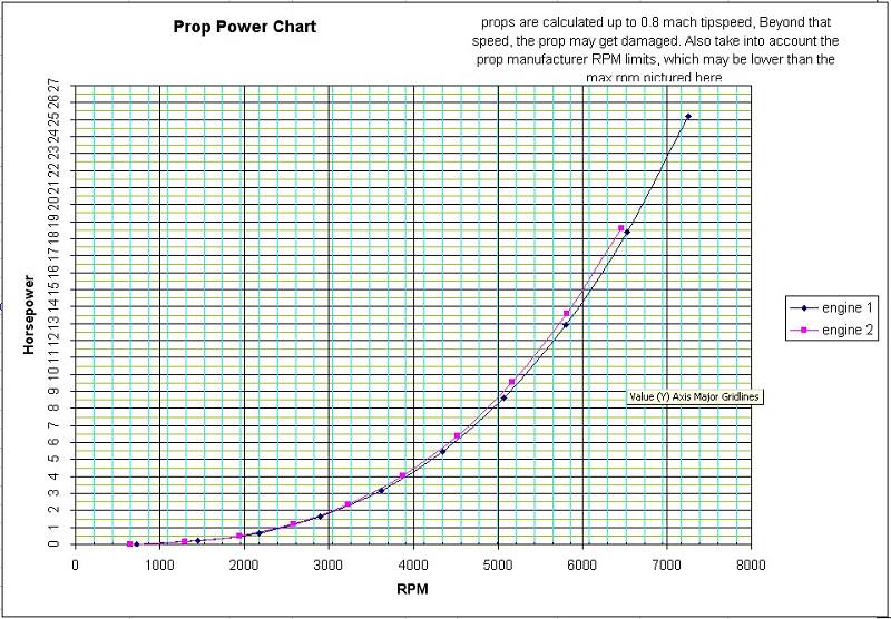

Here are the power curves of the two props you tested. I get almost 13 hp
The two are indeed almost the same. The 32"prop (engine 2) might be a tad lower revving.
Dick did a nice job, Chapeaux

ORIGINAL: pe reivers
That would be a very low 5.23 hp. Surely a DA50 can do better that that on a tuned pipe.
Pe, remember this is about 1400 meters elevation, so it is closer to 4.8hp or so. Still, 30+ lb of thrust @ 56 knots and SILENCE is an excellent figure, and transition is far more important than peak power.

@ Bterry,
Altitude will not change rpm for a certain prop, because the lower load will be compensated by the lower available oxygen for the combustion, power will be even lower though like you already stated.
4.52 horses, and 30.5 lbs thrust is what I calculate from your data at your altitude.
