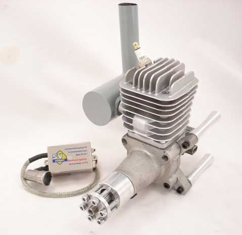

Looks like sv50 went back to the drawing board.

That looks nice, I wonder if I'll ever get one as a replacement for the one they promised me after the 50 they sent me destroyed it's self on the first fight and almost shook my plane to pieces. Waiting........................................... ............................

Pictures are wonderful things to look at. Unfortunately they don't tell you a thing about the metalurgy, the tolerances, bearings used and alignment, piston cylinder fit, crank hardness and welding quality, carb quality, porting, or any other factor that determines if an engine is worth having. Keep that kind of stuff in mind when you see the low prices.
You can make up a nice 3d model out of clay, fire it, and paint it to look like the best engine ever made but it won't ever run. Heck, you can even buy a good engine made by someone else and advertise a picture of that engine as one of the products you make. I mean, ( in the manufacturer's mind and thoughts) just how smart are the people that are going to buy this stuff anyway?
