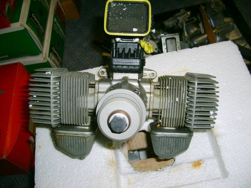

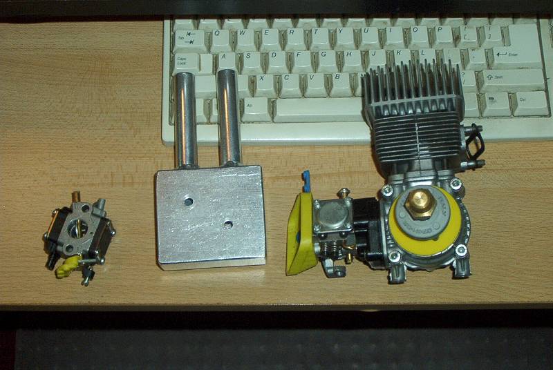

fancman
""A gas Carb will not work with alcohol""
that's funny, MVVS, Tartan and other ARE selling methanol burning engines that have Waldro's on them, they use Walbro's because they have pumps in them !!
""Why in the world would it""
very simply put, more power !!
here are photos of my Methanol burning 22cc Super Tartan with a Walbro carb and my Methanol burning Super Tartan 44cc twin with a Dellorto gasoline carb,, later Tartan engines all came with Walbro carbs (that I know of),,,
altavillan,, I was not talking about poorly or badly running engines,, what it come's down to is just because a given brand sells a carb on their engine doesn't mean that that carb is the best performing carb for that engine..
for those of you that don't just understand why I called Walbro in the first place it was because I would like to by a Walbro to replace the Dellorto, and I wanted to know more about burning Methanol threw their carbs,,

I agree with Wasp, that is funny.
Back in the Seventies, I was into dirt track racing. In some locations, racers would use alcohol instead of gasoline, by (1) pressurizing the tank to feed fuel fast enough, (2) using 3 Strombergs, to distribute the fuel better through the intake, and (3) drilling out the jets, to provide the higher flow rate necessary. A side benefit was the reduced cooling requirements - you could use a smaller radiator, and put baffles in front of it to keep the fins from getting plugged or bent.
The Eighties saw the introduction of butyl rubber carburetor floats (that would absorb water, I understand, and became too heavy to float in gasoline or gasohol) and (in the case of Chrysler) some accelerator pump materials that would shrink (making the engine stumble on acceleration, like when turning left in front of traffic...). And one of those commercial engine manufacturers (Kohler?) started using a float that was like a ping-pong ball, it would swell up & stick in the float bowl when used with gasohol.
Memories of those experiences from the Eighties may be having an influence on some of the comments here, but I don't recall as WalBro was ever on the list.
Best wishes,
Dave Olson

You just described why so many "older" vehicles were destroyed by fires in the engine compartments every time they changed the gas additives in California about 12-15 years ago. They failed to consider the effects of some of the additives on fuel system components, causing leaks.
As you noted, you can obtain more power with methanol but only if using a lot more fuel per cycle at higher compression ratios. A side benefit is that the type of fuel and the increased flows assist in cooling. Experimentation with jetting is everything if someone wants to run alky fuels. The people doing all the scale racing are the ones that have been doing just about all of the work in this area. Since it's generally the unlimited class of racers where anything goes engine wise to help win they keep thinks pretty close to the chest.
