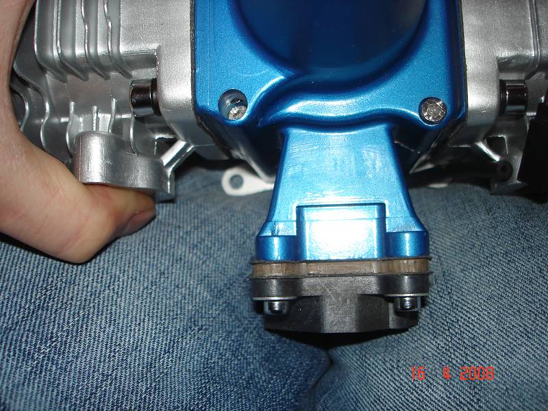

Ordered a Grpro twin, and got it home today. If this is one of the "good" chinese engines, i realy wonder how the bad ones are. But im a bit confused....
The one positive thing i could tell, is the carb. Walbro made in japan. looks nice.
The engine had a bit gasoline in it, and have aparently been used. (Tested?). Well, the carb is totaly unused.
No name on the engine, i have seen in other threads that the engine comes with Grpro on it. That makes me wonder why mine dont...

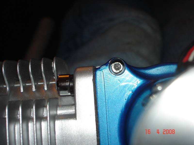

The engine looks like somting that came out of a dogs xxxxxx.
looks like they had a bit of a problem getting some of the bolts in. They have grinded of the bolthead to make a fit in the hole that it goes in, so mutch that it now has paperthin wals. som pics of the bad bolthead, and a good one.

I havent started the one i got. I dont need to. There is no way i can get the bolts on the prop to enter. Sparkplugs wont flush with cyl head. Bolts for the carb was missing also.

For professional and ethical reasons, I won't chime in on the quality of the GRPro engines but I will state the following.
Unfortunately a "not so ethical" person used some RCGF pictures to advertise his products. If you look at the cast carb mounting spigot on the photos of perche's actual engine you will see that they are in fact a different engine.
I have inside knowledge that this issue has been the subject of discussion between the two manufacturers who are located in the same Province here. It is also a driver for changes to some markings on the RCGF product.

So u are saying that the engin on the last picture i posted isnt a GRpro?
You are correct. Unless GRPro suddenly started making what appears to be an exact duplicate of an RCGF 100cc bottom induction twin. The picture in the first post is GR, but not the pic in post 4.

Is it Rear Induction or Side induction?
If possible - take off one cylinder and look to see if it has rollers or bushes on the connecting rod.
Due to significant improvements being made to their product lines, The RCGF factory recently sold off their entire stock of early model engines to a 3rd party "generic brand" dealer (you might be surprised at how often that happens amongst some of the manufacturers). It is possible that they have fallen into the hands of others who are now selling them as their own brand.
All Current Model RCGF Engines have the RCGF Trademark and a Serial Number. That was only instigated about a month ago.

It is a side induction engine. Same mufflers, same ignitione, same carb-a Rcgf engine. Having som sudden death issues. not sure if it is a falty ignition modul. i wil take off one cylinder and see if it has rollers. my gues is not.. i am doing this tonigth.
Im quite happy with the engine turning 6200 with the metz 28/10. Realy looking forward to leaning it.
