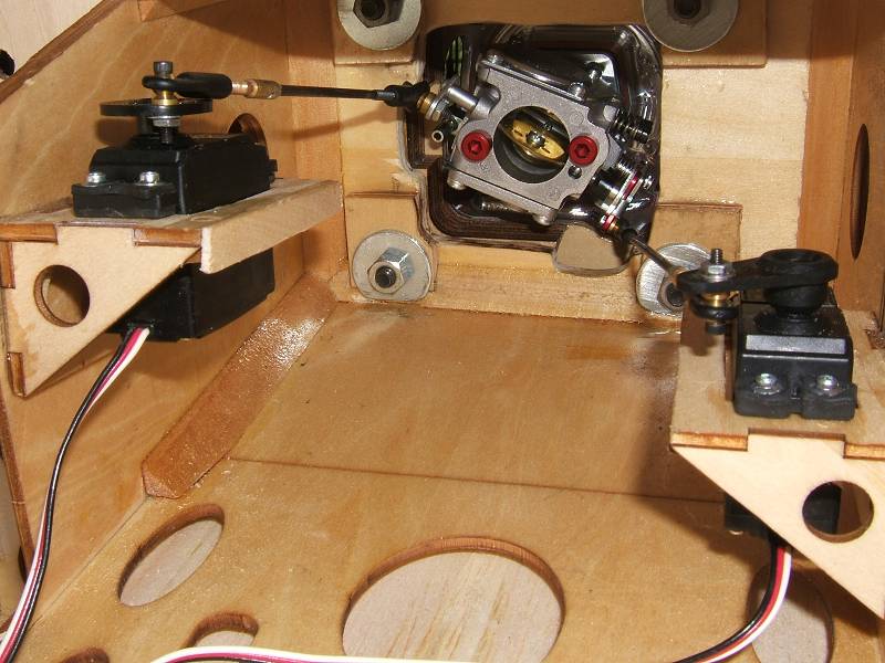

I am trying to figure out how to hook up the throttle and choke on my DA-85.

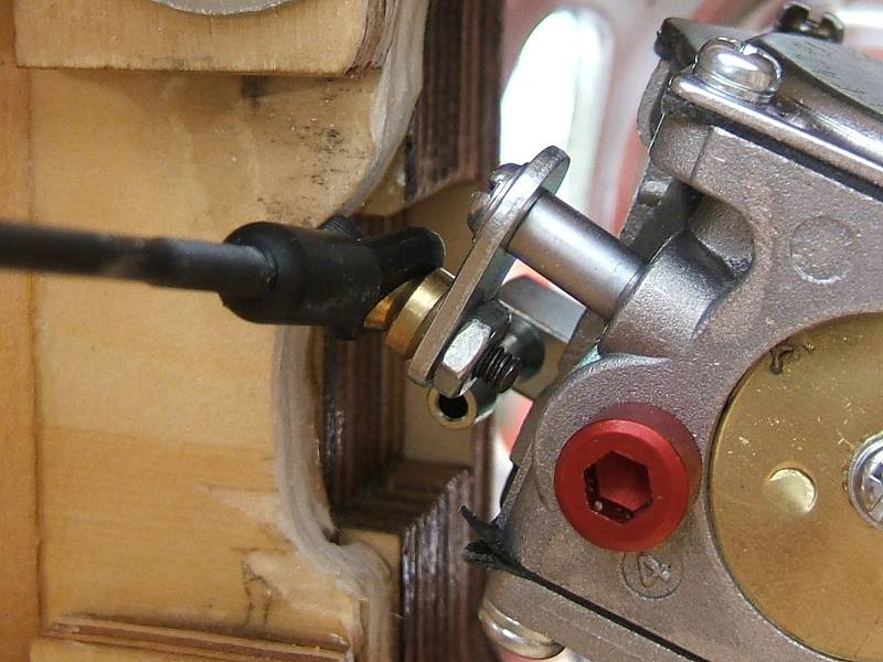

The thottle lever has a tiny hole in the red attachment lever. It looks like a 3 machine screw might work here.
I want to use a ball link if possible. Should I try and find a nut for the back side? It (a 3) will thread into the red thingy.
Choke is different it has a larger hole, possibly 4. I want to use a manual choke but still prefer a ball link attachment method.
I really don't know what to do here!! I have searched for pics but can't find hardly any. Pictures help me alot!!
Please help guys, I want to do this right.

I'm pretty sure I used a 2/56 bolt on the throttle and a 4/40 on the choke. I know I did not drill out he hole. Either a 2/56 or a 4/40 fits that throttle level. I can't believe how nice that DA85 is. Its my first DA. Started right out of the box, haven't touched the needles and it just purrs. Expensive yes but nicest motor I've owned.

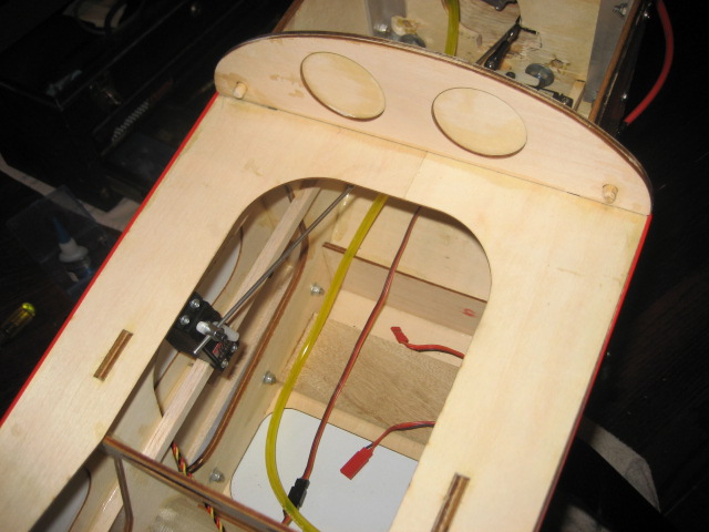

_ pic is worth a 1___ words
