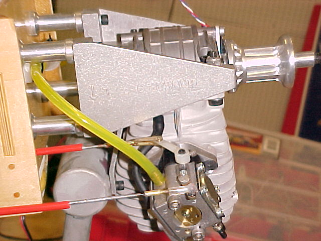

My standoffs are made from 3/4" aluminum bar, drilled out to let my 10X322 bolt slide throuth and then machined down a little in the center to remove additional weight. Heck...I weighed the standoffs on a digital scale and together they weighed less than an ounce and along with the glass filled engine mount you're talking about 6oz total for the engine mount. Don't quote me on the exact weight but I know it's ounces less than the Hangar 9 and three or four ounces that far forward makes a lot of difference
Old 05-04-2003 | 02:38 PM
My Feedback: (16)
Posts: 1,354
From: N. Charleston, SC
Default Take a look at how I had my 44 set up
I could have set the engine back even further in the mount and used a little longer standoff.
http://www.rcuniverse.com/attachment...&postid=912060

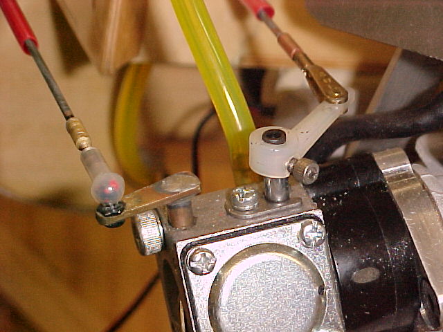

Hey fancman, did you change the arm on your choke in order to hook a servo to it?
Old 05-04-2003 | 11:12 PM
Posts: 231
From: Tracy, CA
Default Great Picture Fancman!
That's a clean looking install.
Thanks for posting that.
Scott

Now that I have taken both the Hangar 9 aluminum mount and the Great Planes glass filled mount to the Post Office and weighed both on their digital scale I've found out that what I percieved as a couple ounces difference in weight turns out to be only about a half an ounce difference between the two.
The Hangar 9 mount weighs 5.6 ounces and the Great Planes mount that came with my 1/4 scale extra weighs 5 ounces. Until I get my fingers calibrated I won't be making anymore comparisons without first going to the post office and finding out the truth.
As for the choke arm. I ground off the end of the carb rod, took out the choke butterfly and then made a new arm out of brass and silver soldered it in place of the original arm. A more ingenious modeler on another thread found an easier way to accomplish the same thing. He went to his local hobby shop and got a metal rudder arm made by Prather and slid it right on in place of the original arm and tightened the set screws and was done. Most arms are nylon with an insert but the Prather is solid aluminum with the set screws and fits perfectly.
My choke is actuated by the retract channel and works great. By the way. I read another thread where the guy took out the detent ball before he reinstalled the butterfly and rod. Don't do that. The rod will be loose in the carb and genertate RF noise. ASK ME HOW I KNOW!! Adjusting the travel on your retract channel is all that is needed and the servo doesn't bind even with the detent intact. Using the metal arm you don't have to mess with taking out the butterfly or rod. Simple.
Scott....Looks like the only way to get a lighter mount is to use the titanium as you have began. Good luck with that.

Final answer.
Thanks for the pics... nothing beats a 2nd way to kill the engine in the air. Especially if the throttle linkage comes off or breaks. Some of these gas engines can run over an hour before running out of fuel.
